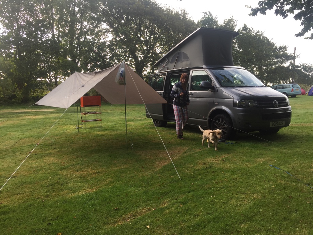

Storm Porch MK 2, courtesy of Nick at Comfortz.
So the MK 1 version used a cheap tarpaulin, but the eyelets failed as the plastic stretched. Principle was OK, just the tarpaulin and it was the only one I could find of the size required. At COTF I had a chat with Nick from Comfortz who has come up with a lighter, waterproof and suitably reinforced awning of the correct size, 2.5m x 4m. Here are some photos of it erected on our local common.Storm Porch1 (1 of 5).jpgStorm Porch2 (2 of 5).jpgStorm Porch3 (3 of 5).jpgStorm Porch4 (4 of 5).jpgStorm Porch5 (5 of 5).jpg
Ok if you got no awning , but if you have a awning like yours is'nt it much easyer to roll it out and have just the extra sunblocker ( or whats it called ) ? It does the same ...no?
But nevertheless a good job...
I camp in winter, wind rain or shine. This setup costs £90 the main awning £450. In severe weather conditions, an awning is useful and if it got damaged then I know which one I would prefer to replace/repair.
Also, if the weather got really severe then I can unclip the awning from the California awning cassette in 30 secs and the whole lot is flat on the floor. I don't think I could wind in the California awning in less than 5 to 10 minutes.

Sorry, that is the last thing we want. But when it is unwise to wind out the expensive awning then the cheap, simple storm porch allows us to leave our wet coats and wellies outside under cover.
And do you really have such faith in those weather apps. I've yet to find one that is that accurate.
I'm more worried about the damage the (any!) awning could do to the van if the wind really got up. There is a good supply of spare parts for the awnings at a very modest cost vs. the cost of paint / panel / glass repairs to a Cali..
Oh go on, live dangerously.
If the standard awning got blown over onto the vehicle then I don't think your supply of spare parts at a modest cost are going to be much use. Just a new, complete awning + damage to vehicle.
My storm porch however, if it lifts up then the poles will fall down and as only 6' long but placed 8 ' from vehicle unlikely to hit vehicle. 8mm elasticated cord. Will keep awning attached to vehicle and the Rock Pegs I use until I take it down.
I have been using a similar system on my Defender for some years without any problem, but then it didn't have a £400+ wind out awning that cannot safely be used in severe weather.
