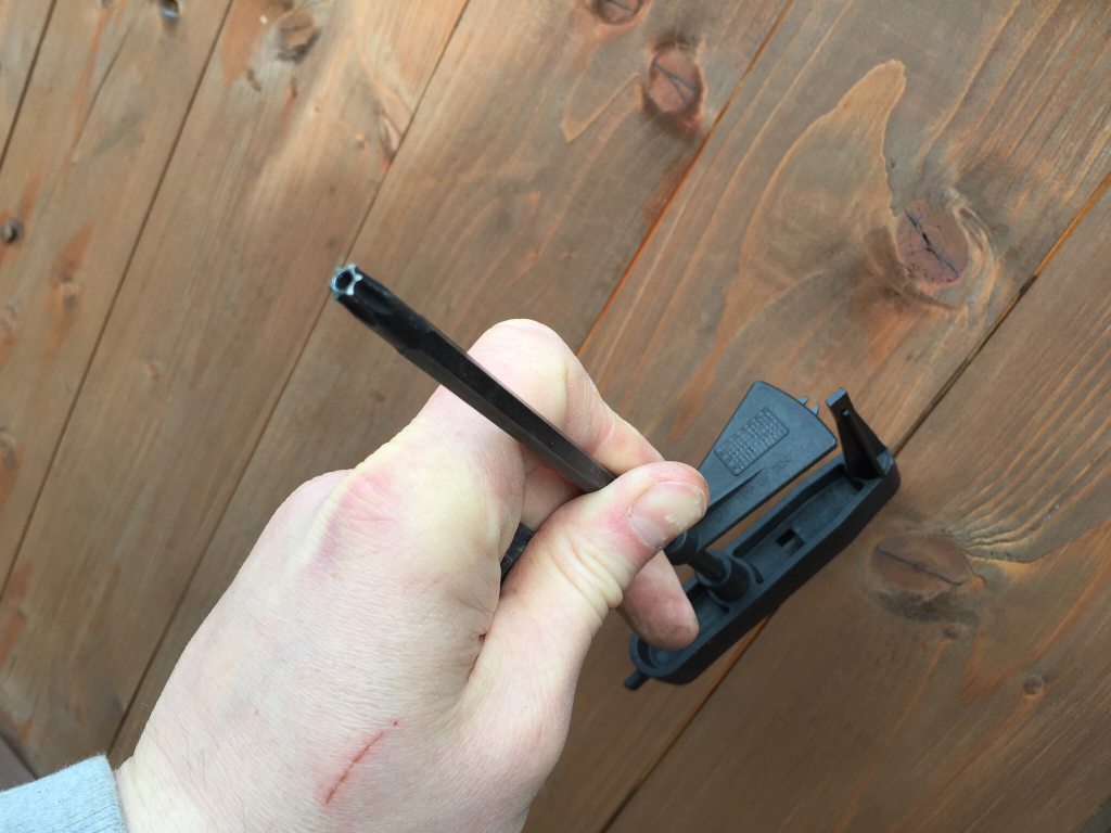

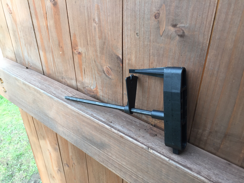

The rack comes with a torx security bit with a built in torque wrench, supposed to tighten bolts to 6nm. Did you get that off the dealership? Loosen the two bolts at the bottom of the rack and move the clamp metal bits off the lip of the tailgate and the whole thing should lift off.

Any hardware store should do the torx bit
Here is the tool you need. I'd recommend you give the dealer a bit of stick if you don't get it, would make removing the rack a lot more tricky otherwise.

I have a torque wrench for my bike, used that to tighten the bolts as it is more accurate that the tool supplied
Thanks David, the tool was left in the glove box by the dealer in fairness but no user instructions and no protective tape left or fitted. It's really only the wheel wedges that I'm not sure about. They move if you force them but cant see a way of loosening them to slide freely. Surely these will slide off the rack after a bit of use? Or nicked by somebody missing one off their bike rack own haha...
