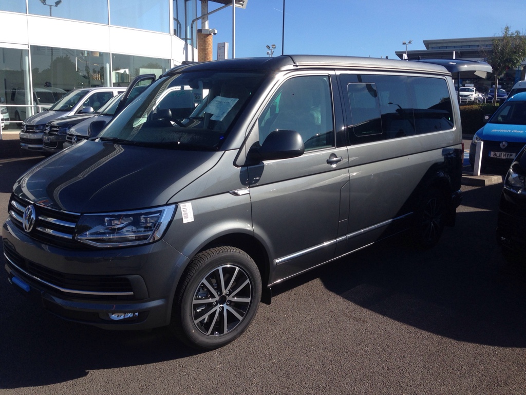

Probably a good time to put up the one picture I took of it before discovering that it didn't have the 4Motion I ordered. Indium Grey with chrome pack. Black B Pillars and all.

Looks nice. I didn't order the chrome pack, mainly because I didn't know about it at the time! What color are the B-pillars as standard?
B pillars come body colour as standard and break up the flow of the DLO.
Not to worry. You can buy a B pillar wrap kit. I did mine a few weeks ago. It cost £25. Buy on eBay. Quite easy.

Looks good Mike. Heard about the small omission in your spec when it turned up. Not great. What are you going to do now? Has the dealer sorted a solution?
Still working on it. More phone calls today. I'll give an update when I get it finalised. Ta!
