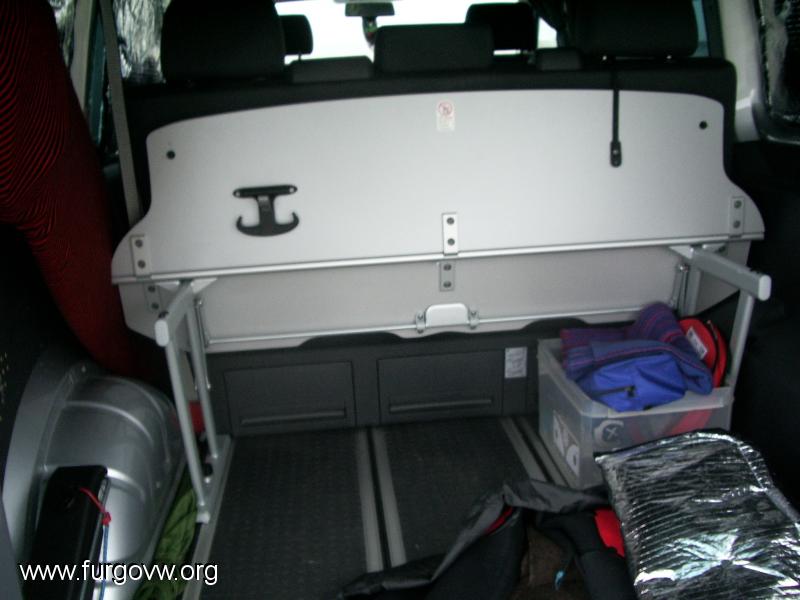

Not able to measure right now but does this take into account the mechanism and lever to drop the section closest to the seat? The MFB on three seat folds to make it shallower and the mechanism for this is on the underside.
You can see it in this pic (not a Cali obviously) in the folded rather than upright position, however you'll note it's close to the seat so assuming your approach is cuboid, your storage system could be made to push up to it creating a small cavity down by the plastic doors to the slide out trays. HTH.
Thanks very much, really helpful.
