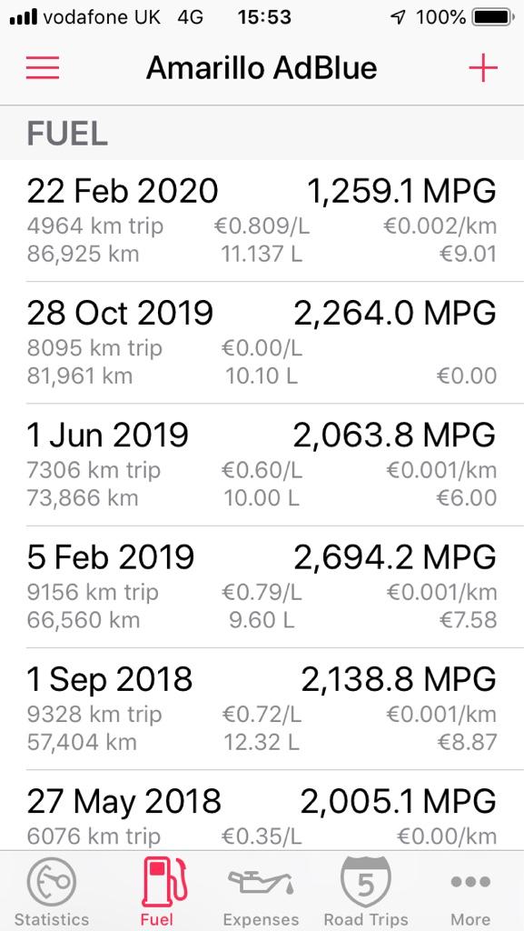

Before the AdBlue fix I averaged 2231.8 mpg (39,961 Km and 51.7 litres).
My latest refill suggests a drop of nearly 1000 mpg at 1259.1 mpg.
