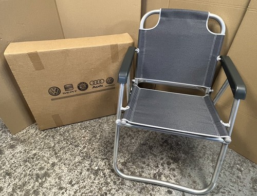

Thank you. Very expensive though.VWT5 T6 California Ocean, Beach Folding Seat Chair Decking Chair7H7069001C New | eBay
<p>Genuine VW T5 T6 California Ocean,</p><p>Beach Folding Seat Chair Decking Chair</p><p>Part Number 7H7069001C.</p><p>Will Fit All T5 T6 Transporters From 2003-Onwards.</p><p>For more information please contact 07786789996</p>www.ebay.co.uk
