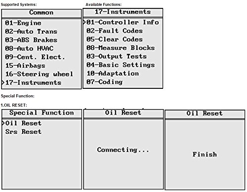

This is the device I am looking at, cost £41 and reportedly gives access to everything VCDS does (although perhaps not so user friendly).
Looks also like it allows coding access:

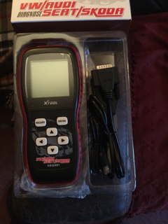

First experience.
So I updated it last night, it seems to have been updated last at the end of 2015. The update was incredibly slow as was the update tools download. If you ever get one you must back up the files on the SD card before you update. It took 3 attempts and a reinstall of the software to get it updated.
At the moment I've only plugged it in and looked at the menus.
Device is quite large and seems solid yet light. Comes with usb SD card reader to update the firmware and vehicle data. Works fine but SD and usb are very poor fit and cheap (to be expected?). I also nearly put the SD card into the shell because of a small gap by the SD slot.

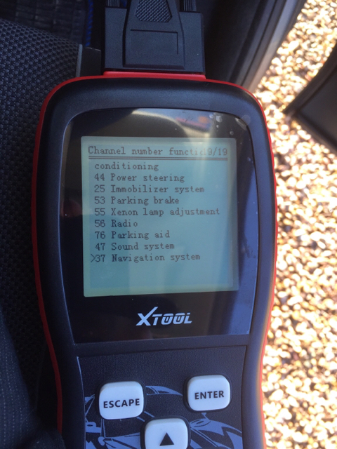

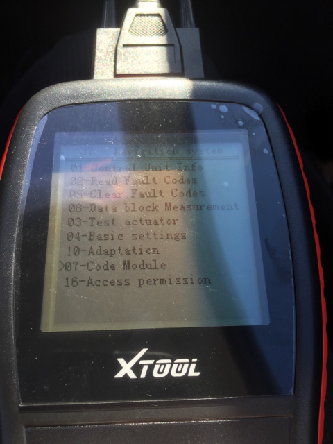

Plugged in this am to see what codes are available:

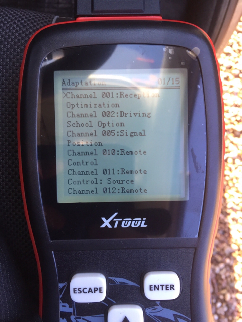

Seems to have everything there but it isn't as user friendly as VCDS. You will need to research before you change anything as once in the menu it's not entirely clear.
I could see navigation and radio menus.
However once inside its not so clear and will need research. Powerful in the right hands I wager.

navigation coding is available takes a minute or so to appear.

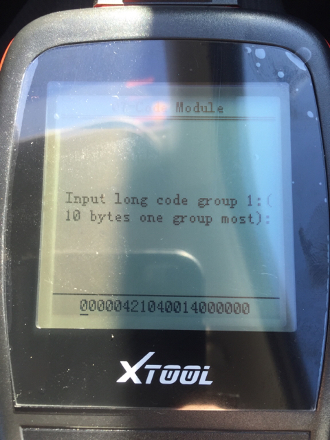

Coding is where my knowledge runs out so I didn't make any changes here.
Very impressed although maybe not for the faint hearted.

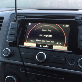

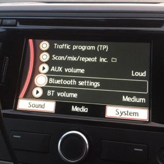

The best thing is I haven't had to install BT. I was ready to fork out 150 on a Denison BT kit but this head unit already had it but disabled by Vw ( they wanted £360 to install BT).
Just need to install a mic like the one you've linked and I'm good. That little device has already paid for itself.

Worth adding on first try I actually disabled the DAB when I enabled the BT, but I now have both working. It was an educated guess change to the code though which was a little scary.
The device certainly works well but you genuinely have no idea what you are changing. You either need the workshop manual from VW or perhaps the VCDS helper may be a good. Not sure if it works without being connected up?
