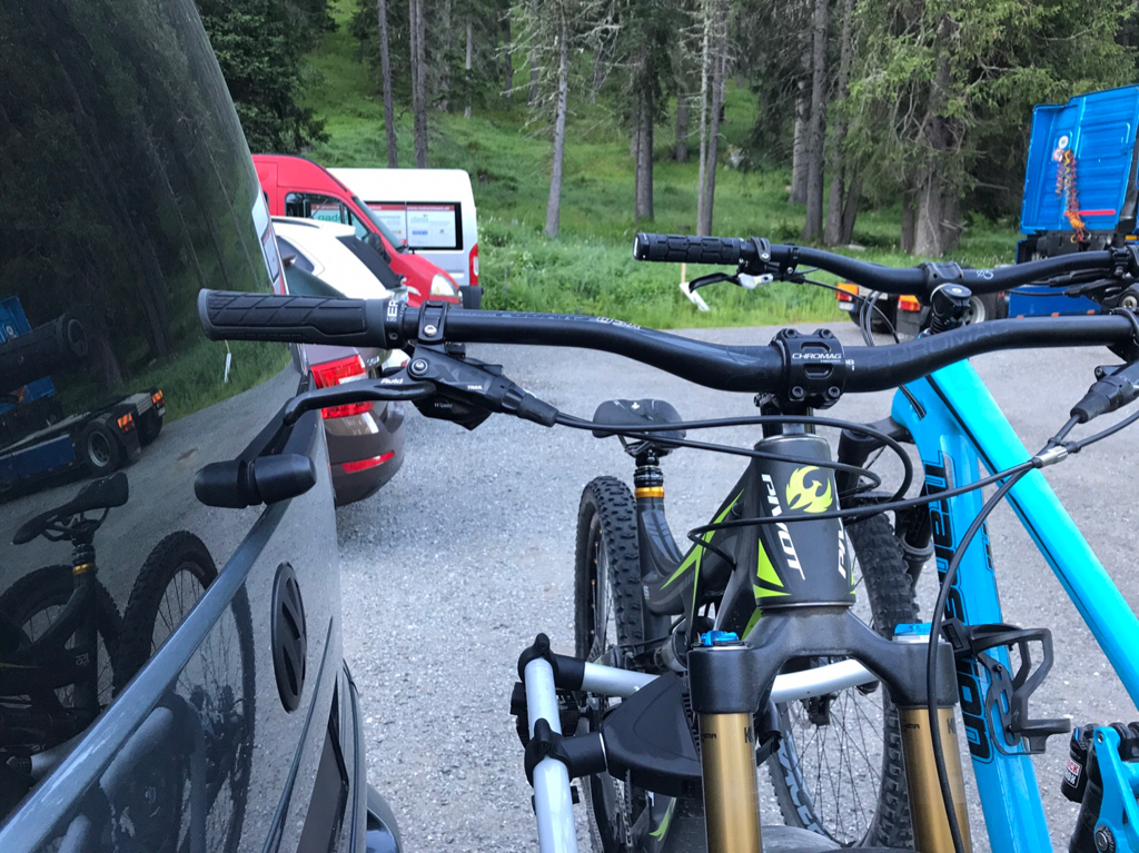

I have an aftermarket fitted Westfalia towbar and a DL3: Everything is okay execpt the wide bars of my DH bike (I like the sliding thing and how easy it is to mount/remount the DL3).

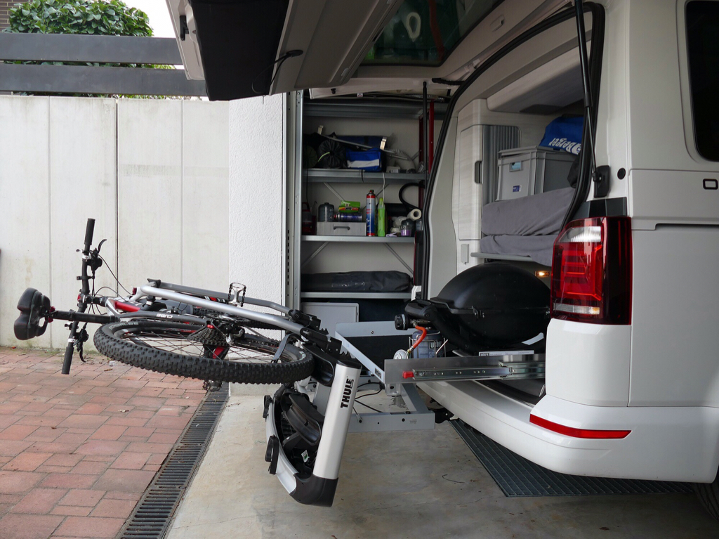

Unfortunately I do not have any experience however one of the main differences is how you "clear/drop" the Atera vs. Thule:
The Thule "flips" down whereas the Atera slides down (sorry, is "flip" the correct verb?).
Both have, as long as you turn the bars, enough clearance to open the tailgate.

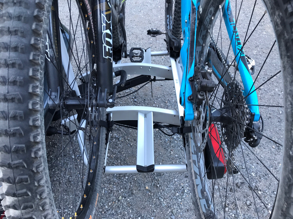

Personal I wanted to have more space between the bikes so I only use the "car-closest and the car-farest" space to carry our bikes.

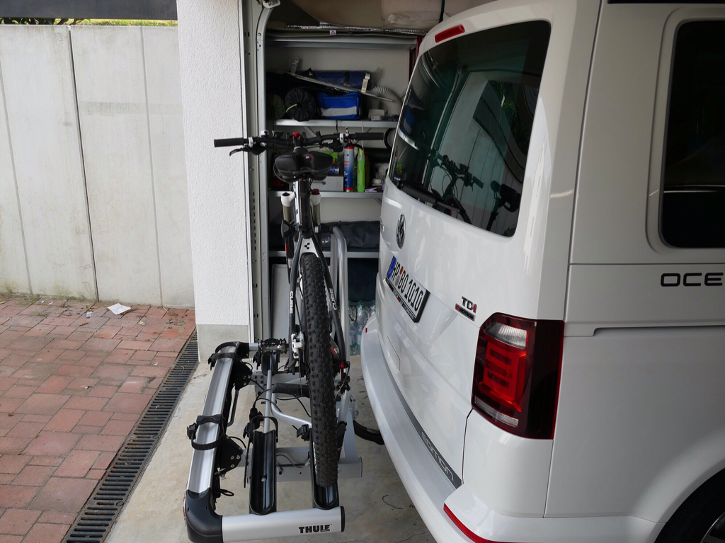

Is that a Thule 929?
If the spacing is the same on the 2 and 3 carrier, I agree the 3 bike carrier looks essential for 2 x mountain bikes with wide axles. This is helpful to see. Thanks.
