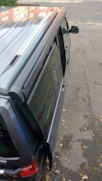

Hi WG, do you know of any way to raise the entire awning rail a bit higher? When I attach my Vango Cross Air awning using the kadar strip to the awning rail, the sliding door always catches on the kadar strip/awning when the door is opened because the kadar strip hangs just low enough to where the door catches it. I've retracted the actual awning as far as it will go to ensure there is tension on the awning tunnel, but regardless of what I do, the door constantly catches the kadar strip. If I could raise the awning rail a cm or two, that would solve the problem. Appreciate any help you can offer.

Personally, I don't use an awning but you cannot raise the awning vehicle attachment without some major engineering of the brackets and ungluing and re-gluing the rail to which the awning is attached.
Can you use the legs of the windout awning to push it up slightly or will that interfere with the Kador attachment?
Or park a little further away so that when the windout awning is wound in to tension the tunnel the kador attachment is further from the vehicle allowing the sliding door to open behind it rather than onto the attachment

Roll the roller awning out slightly & then attach the kador strip, then you can use the roller awning legs to raise the height of the connection point in order to clear the sliding door.

Thanks! I tried that and it looks like it will work, but the kador strip channel is tight fitting over the awning edge. I may need to sand the channel a tad to give it a bit looser fit. I'm nervous the tight fit will scratch the awning edge.

Thanks WG. Good advice. I'll try that.
No need to sand!...Your connector might be the wrong size, get one of these; It can also be used on the other side - non roller awning side of the van (you just slide two of the strips into the channel), which comes in handy when its warmer as you can still enjoy an open view from the roller awning & then put the freestanding awning on the other side of the van:

Hi GollyOlly,
are your figure if 8 strips plastic ?
they are a tight fit initially, the edge of the cassette is double thickness (safety edge) the plastic figure 8 simply pushes over the edge, which is tight and prevents it coming off inadvertently.
if you push one end on first the figure 8 fits easily over the safety edge
once the initial resistance is overcome the figure 8 strips are not tight on the wind out cassette, I fitted some helicopter tape to the front face of mine, although the figure 8 clips have not marked the tape
edit, as said above do not sand, check the size of the figure 8 strips
It's difficult to tell from the picture but it's the 6mm from Vango. I'll try the Dometic and let you know if there is any difference.
