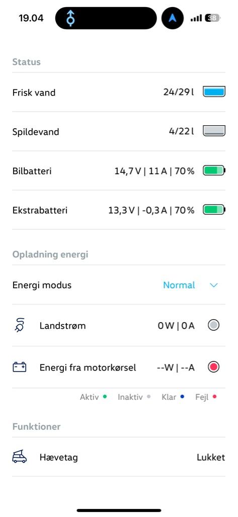

In the meantime, I have installed all available software updates. The vehicle has already been to the dealer several times; however, the problem still persists, as can be seen in the attached images.
In the meantime, I had a solar system from Califaktur installed on the roof. This system keeps the secondary (camper) battery reliably stable and continuously recharges it. From my point of view, this works very well. I therefore hoped that this would also resolve the issue of the starter battery discharging on its own, as the camper battery would no longer place any additional load on the starter battery.
Unfortunately, the exact opposite is the case. As shown in the screenshot, the vehicle was parked for around five days at outside temperatures of approximately −6 to −8 °C. During this time, the state of charge of the starter battery dropped again to only a few percent.
The screenshot was taken while the engine was running, which is why the current values are positive at that moment.
At this point, I am honestly running out of ideas as to what further measures could be taken. If anyone has a solution or has experienced similar issues, I would greatly appreciate any advice.
If there is a relevant software update or a specific technical measure available, I would appreciate a brief response.
