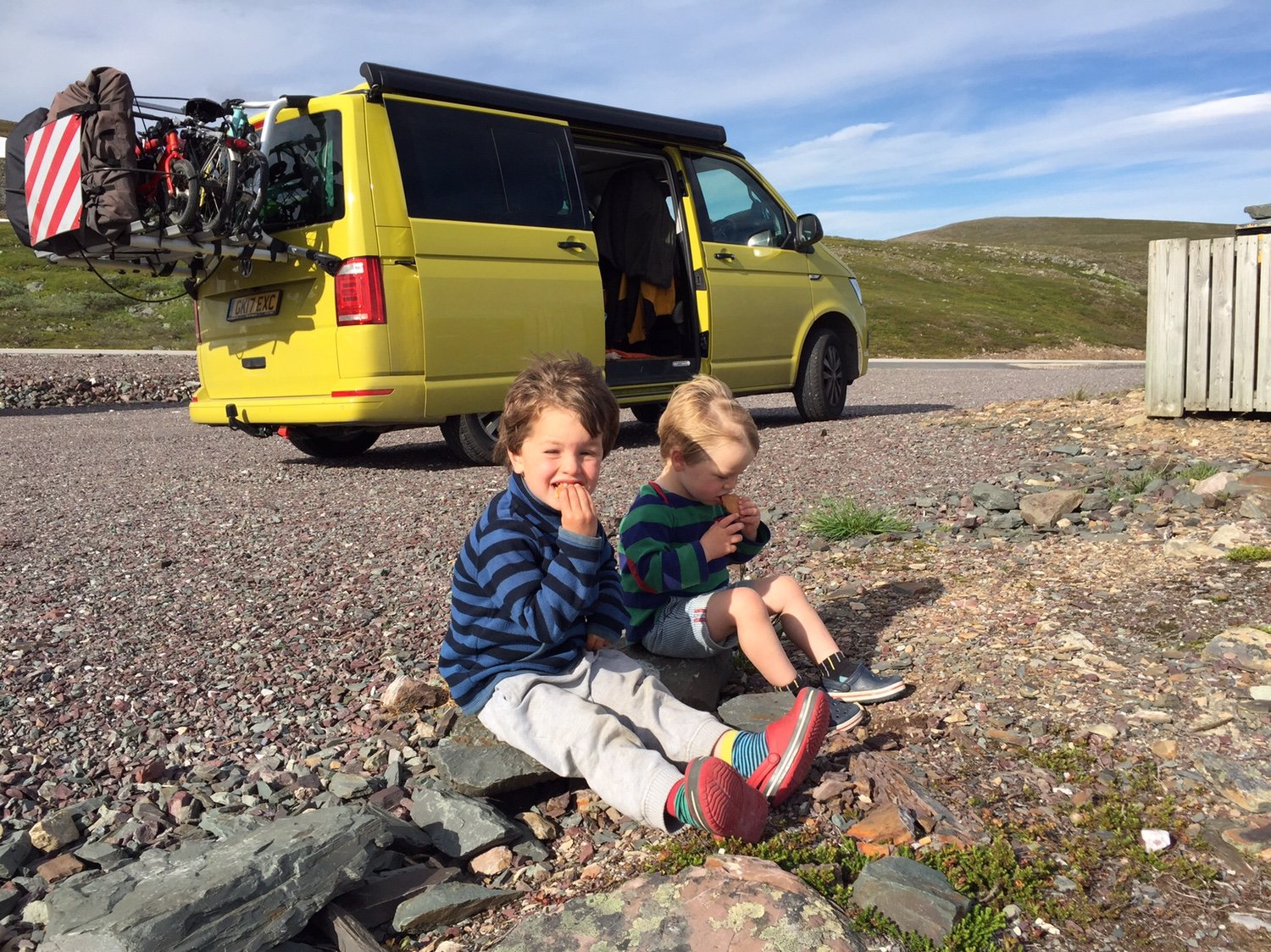

I hauled four bikes plus a two child cycle trailer on my T6 bike rack to and from Nordkapp.
