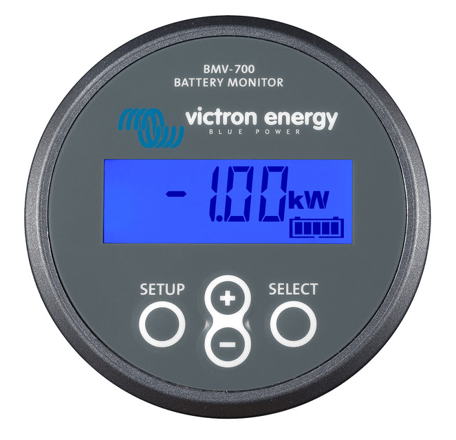

Has anyone fitted one of these in their beach (or Cali).
I really would like one in my seat base but I am not sure if it would actually have enough space behind to fit.
They are reportedly very accurate and give a good idea of charging and discharging, especially handy with my suitcase solar I suspect. I have tried all the cheap 12v monitors but they vary so wildly and often slowly change over time to be useless for telling battery condition. My last purchase which was initially spot on is now half a volt out. This option seems better than carrying a volt meter around with me all the time.

It does a great job giving peace of mind and appears to have similar functionality to the BMV-700 with the same shunt install, etc. Clearly the BMV-700 wins in the design awards over the super clunky BM1!

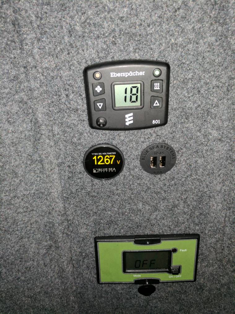

I fitted one of these
http://www.12voltplanet.co.uk/mini-oled-dc-voltmeter-12v-24v-dc.html
The reading is spot on according to my multimeter. It's quite unobtrusive and the display is really clear even in bright sunlight (gotta love the OLED screen!). The price appealed to me - it's not cheap, but the quality is unquestionable... Equally, it's not stupidly expensive (it just measures voltage after all!).
Just saying...
I've got a conversion - so don't have the same panels as a Cali, but I've put it in the small panel next to the rear bench seat (Cali triple) together with a double USB socket for the kids tablets on journeys. I'm fairy sure it's the panel used for the seatbelt mechanism on Kombi's (I hope that helps describe the location?)
It is small enough though to go in the panel at the bottom (rear) of the drivers/passenger seat - I toyed with idea of putting it there due to the proximity of my leisure battery.

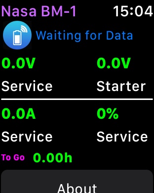

Looking at the app on the apple watch is quite a good idea and although the visual design of the app is a bit garish and old fashioned being able to just check my watch for my battery status is something I like the idea of.

Watch screenshot not yet connected, can monitor the starter battery for voltage only as standard.
