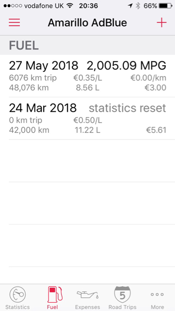

I’ve done 10000 miles and just brimmed the tank a second time. So it’s used two full tanks of AB however much that is. Hope that helps
2005 mpg on a brim to brim measurement.
