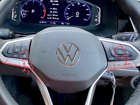

Luckily it’s super easy to, deactivate with 3 quick button presses on the steering wheel which becomes second nature and can be done with eyes still on the road - see photo. It’s LEFT(1), RIGHT(2), LEFT(3)

Sorry @pluc99 I take it back, you are right, lane assist can be turned off separately, by using the menu system (rather than the steering wheel buttons). The menu actions are : Menu; Driver Assist; Tools (cog symbol); untick Lane Assist. So 4 screen actions. If turning off Lane Assist mid drive, I think most people will use the steering wheel buttons for speed and so as not to take your eyes off the road. But it appears you can turn Lane Assist off before driving off.
