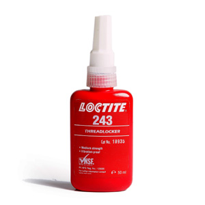

I had exactly the same issue yesterday, fortunately I found the screw and plastic bit on the floor, I have now ordered some thread lock.
I tightened the other screws in the other chair ( they were loose)
Be careful if you don’t use the chairs for a while. The design unfortunately lets the screws vibrate loose while stored in the tailgate.
What’s thread lock, Perfectos?
UPDATE: Fixed the chair -- there are 10 screws on each chair.
I counted 5 loose on each chair with 2 about to fall out.
So I went round every screw and tightened it adding a bit of thread lock to each one.

I think we’ll all be doing it now. I found out about threadlock through this thread, so thanks guys.
