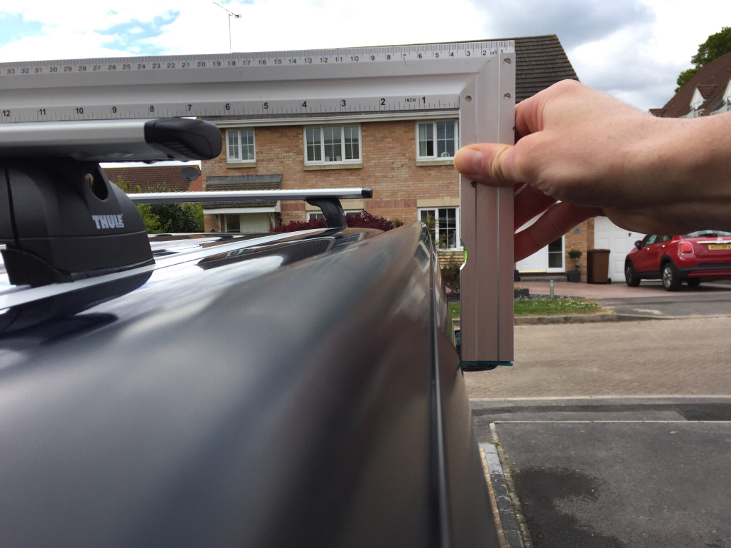

Just wondering if anyone has the Thule Hullavator Pro 898 (lift-assist) carrier attached to the T6 with the standard awning fitted? Wondering what length of Thule Probars required to get over the extra width of the awning? We've measured the dimensions but just wanting to check if anyone has any experience of fitting a pair of these carriers?
We're aware of the Kari-Tek rack but are looking for something which is easier to remove as we won't be using the sea kayaks all the time.

This is with the 135mm wing bars on the low foot pack.
To completely clear the awning they would have to be very wide.
Bars could have been offset by about 5 to 8cm based on the slot on the underside of the bars.

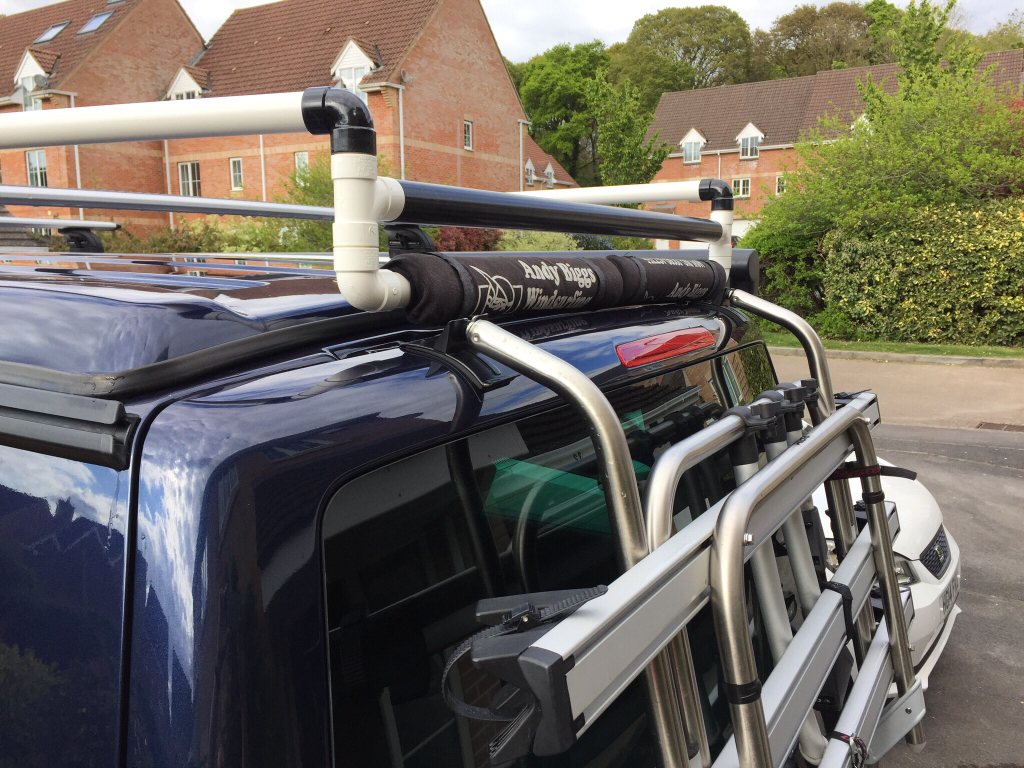

Not those but this is what I've made from plumbing pipe as an alternative.
Long black pipe acts as a roller.
Just saw this, any chance you could advise what you did ot make this? We have been struggling to use our kayak because its so hard to load.
This looks just the ticket. What weight can it take?
Hi Matt,
the transverse framework (white pipework) is 32mm solvent weld pipe, 2 x elbow joints & 2 x T pieces all glued together. The transverse black 'roller' pipe in the photo is 40mm pipe that rolls around the 32mm one underneath it. This framework just sits on the tailgate using the roofrack pads to give protection.
The longitudinal tubes are again 32mm pipe with an elbow and short vertical extension thats a tight fit into the T pieces of the framework (not glued). Out of shot the longitudinal tubes fix to the roof bars with Thule T track bolts & wing nuts. The idea was that I could rotate the longitudinal bars 90deg for easy storage.
The whole thing is only on the roof when loading and unloading, I did try it a couple of times (with a 14ft touring kayak of approx 24kg). It proved the concept but the weak point is the rotating elbow joints. I managed to drop the whole thing and the joint shattered. :( I have mended it and tried to strengthen the joint but not tried using it again.
Since then I have moved to a different way of loading that works better for me and I made in a stronger fashion. Have you seen it on this thread?
https://vwcaliforniaclub.com/thread...yaks-on-a-california.10088/page-2#post-216022
Since the pictures were taken I have made some small adjustments (smaller hooks with straightened lip & reduced length of wooden bars). This setup works well. Used it many times with just me loading the boat, especially last week as I was on holiday down in South Devon kayaking on the Dart and Salcombe estuaries. Fantastic time!
