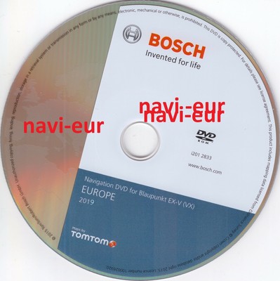

Nice, since when is it possible to use non VW CD/DVD in those systems?
If so, that piece of junk, is no longer junk.
Not sure where you get the “ Non VW “ bit from. Have you read the advert properly?
If I read the advert it only states that it is for MFD2, but on an "original" VW DVD, there won't be BOSCH all over it.
All the VW or Audi DVD's I have seen will have a print of the countries, or another print with some text for legal reasons, but not printed BOSCH in big letters over it.
So, now again: since when can you find non-VW DVD's for VW units?
Do they have the same for RNS 510 and so?
Bosch TomTom SatNav Discs are available for Ford , Mercedes and a number of Japanese car makers.
