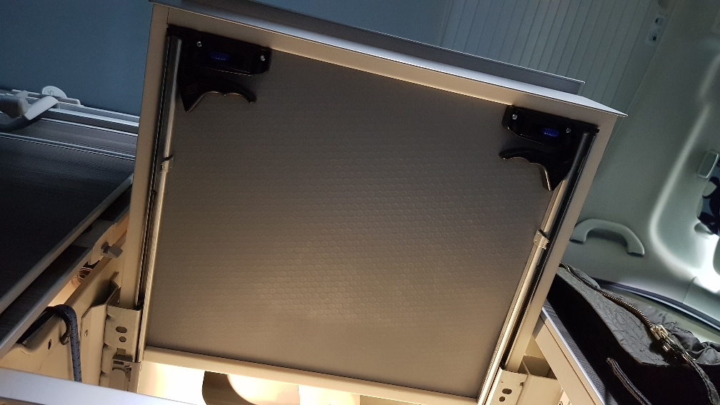

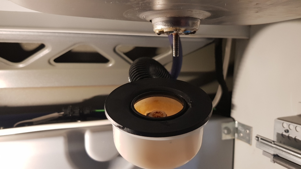

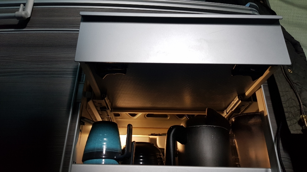

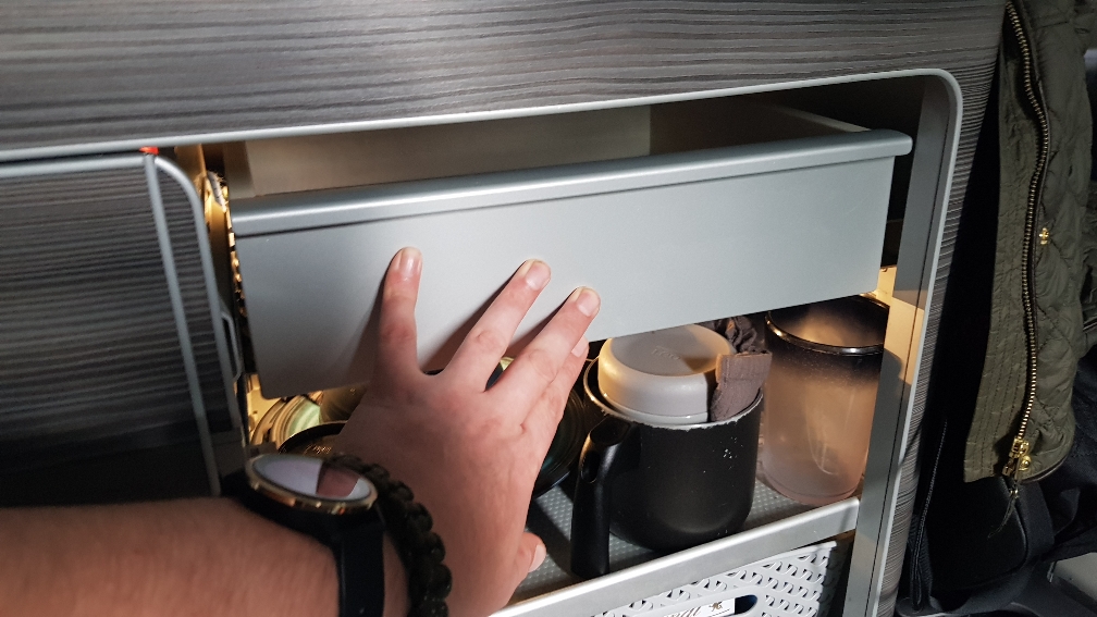

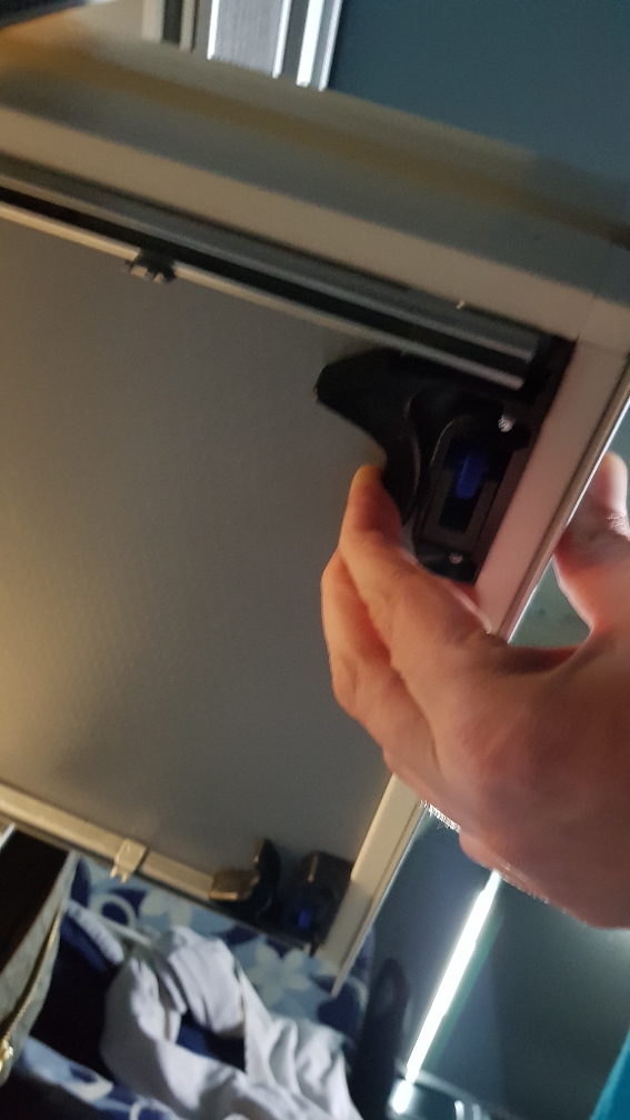

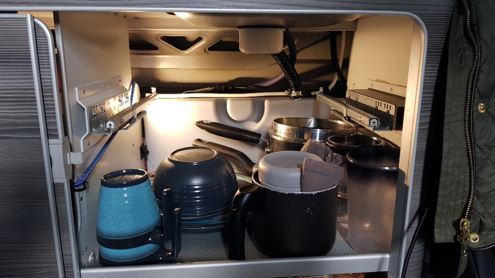

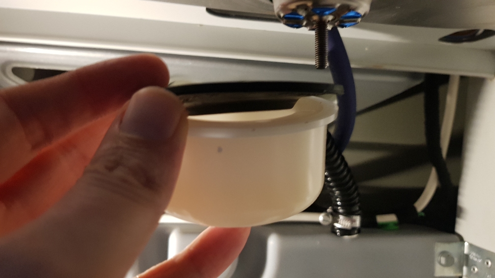

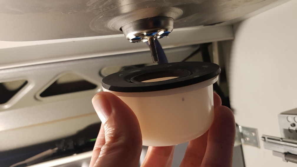

1: Empty shelf, turn on cupboard lights if you have them or put a light source down there, and pull out drawer to its maximum point

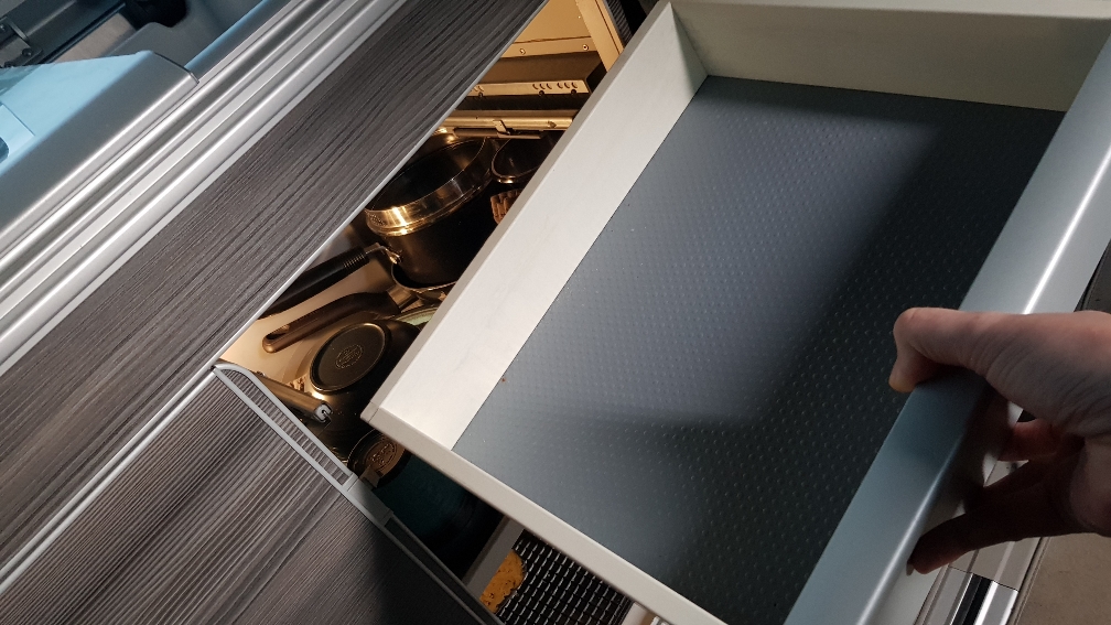

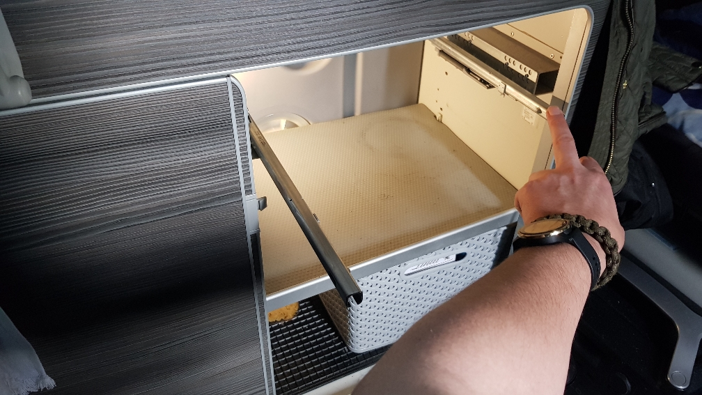

2: Peek underneath the drawer and spot the two squeeze handles
3: squeeze both and pull the drawer out further

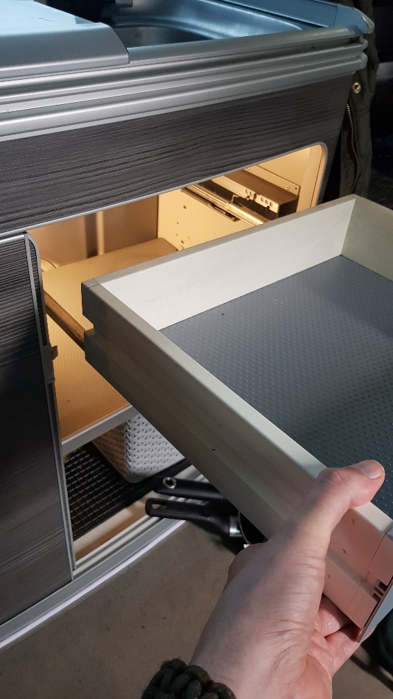

4: Lift drawer out of the way

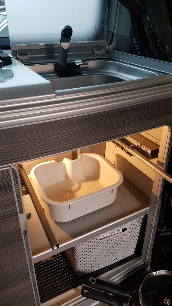

5: Put your sink bowl (or saucepan) underneath to catch any water

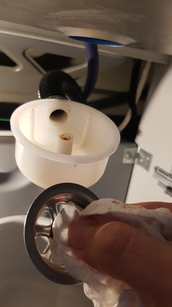

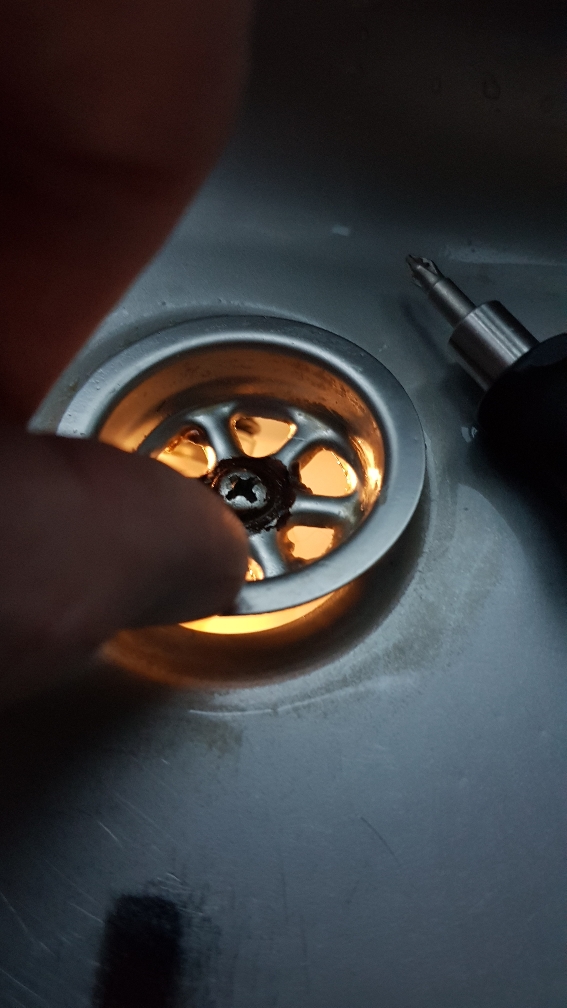

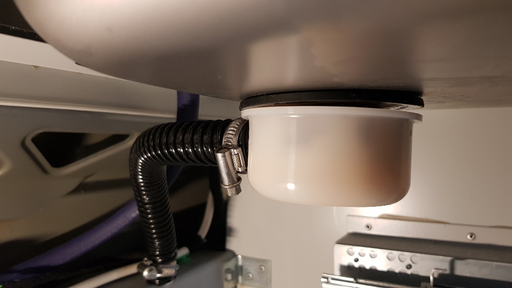

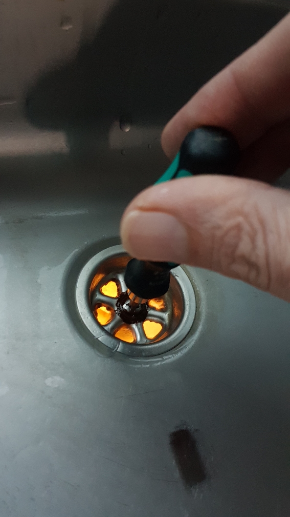

6: With the light below, you can undo the plug screw and gauge how dirty the plug unit is at the same time. If it's still dark, it badly needs a clean!

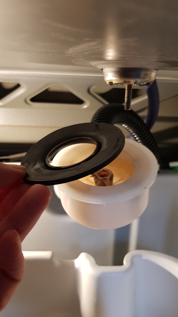

7: Lower section will loosen and potentially drip a bit and if dirty, might be a bit smelly as it dislodged

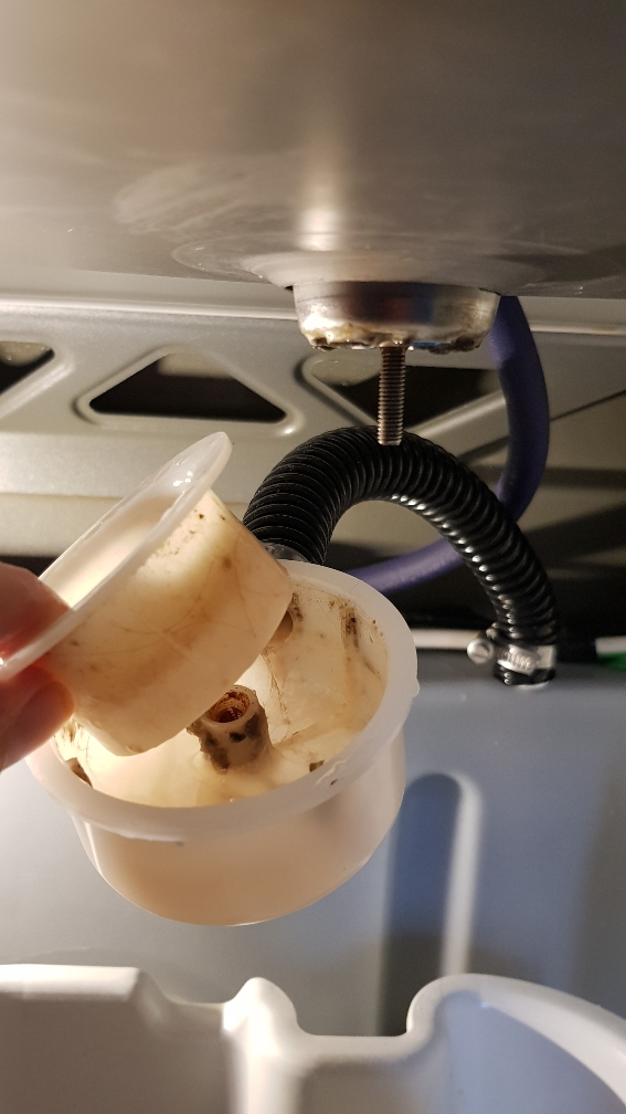

8: Let it fall away under it's own weight and you can have a peek. Reassemble if you think all ok or ...

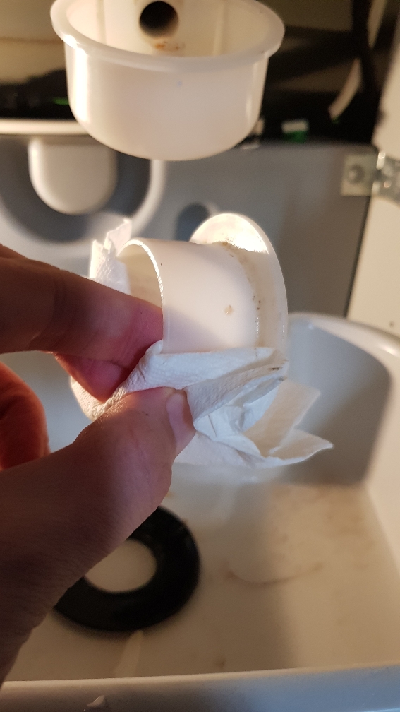

9: Separate rubber seal and wipe it clean with kitchen roll. I feel it's best not to use detergents as the life of the rubber may be shortened

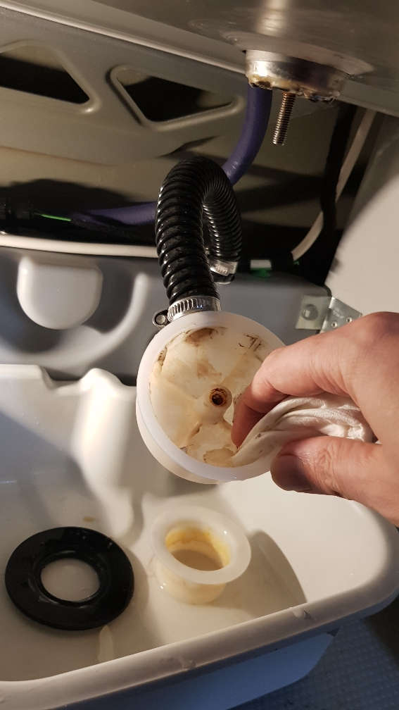

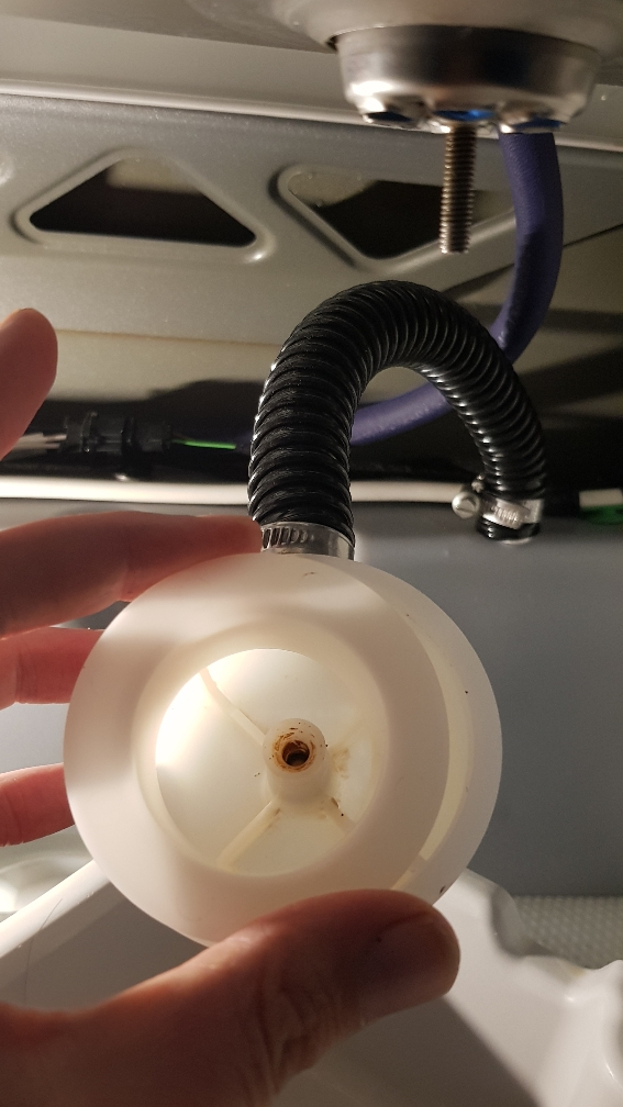

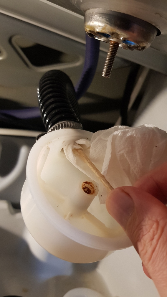

10: Put your fingers deep inside the lower section and lift out the middle plastic piece - can be super gooey in there if hasnt been cleaned for a while!
11: Rub down the main section with a wet kitchen tissue or wet wipe - this piece rarely stains or has issues as its often always moist so everything wipes off fairly easily so avoid strong detergents once again, I feel.
12: Using a small implement like the handle of a tea spoon or a spent tooth pick, gentle wipe inside the pipe to encourage any fatty deposits that accidentally went down from the cooking area
13: Again, using only a damp kitchen tissue or wet wipe, clean the inner plastic piece
14: Lift plug out from either below (might be gooey!) or above
15: Not needed any detergents once again, so wipe clean as per the other pieces
16: Replace metal plug section with screw so it dangles happily
17:Replace inner plastic piece into main section
18: Replace rubber seal with the raised side facing down

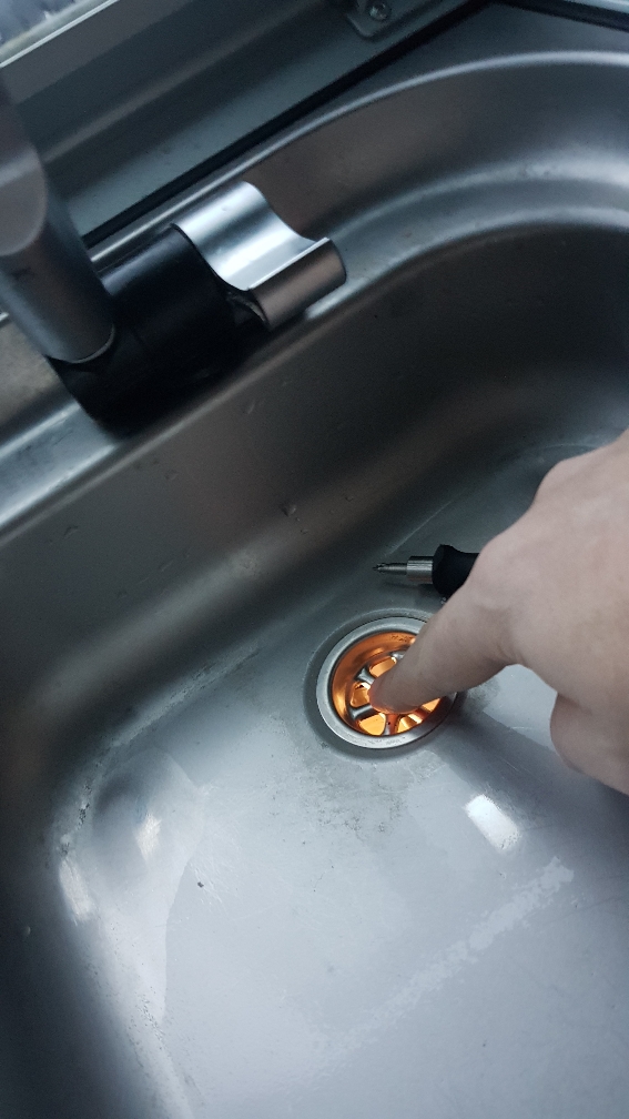

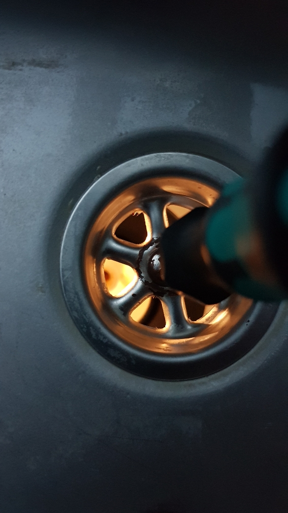

19: Present the lower section upward to the dangling screw
20: Peer down from above to align it - you should see your light source beaming through a clean plug now!

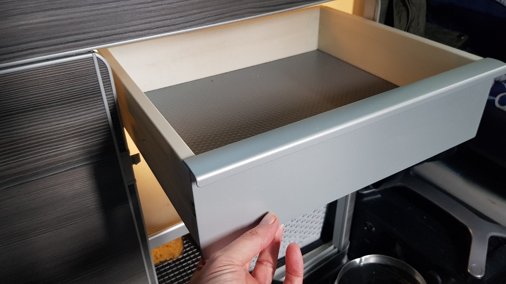

21: Present drawer to the opening
22: Replace your items as it's a little easier with the drawer out!
23: Lay the drawer about a quarter of the way in on the sliders each side
23: Firmly push the drawer into the cupboard until you hear loud securing clicks
