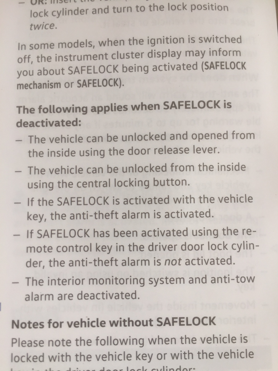

When in doubt - read the ****ing manual.
Point five. The alarm is deactivated when the doors are not deadlocked.
In other words, a double fob press turns off the alarm and locks the vehicle without the deadlock.

what you say seems to confirm that I can carry on with a double-press to de-activate the alarm as long as I’m not worried about the deadlock being off. Which is fine for ferries and when I leave my dog in the van.
If I interpret the double negatives in the manual correctly, a double fob lock followed by a key cylinder (triple) lock will deadlock the vehicle without setting the alarm. This is the same locking mode as pressing the B pillar button and a single fob lock.
