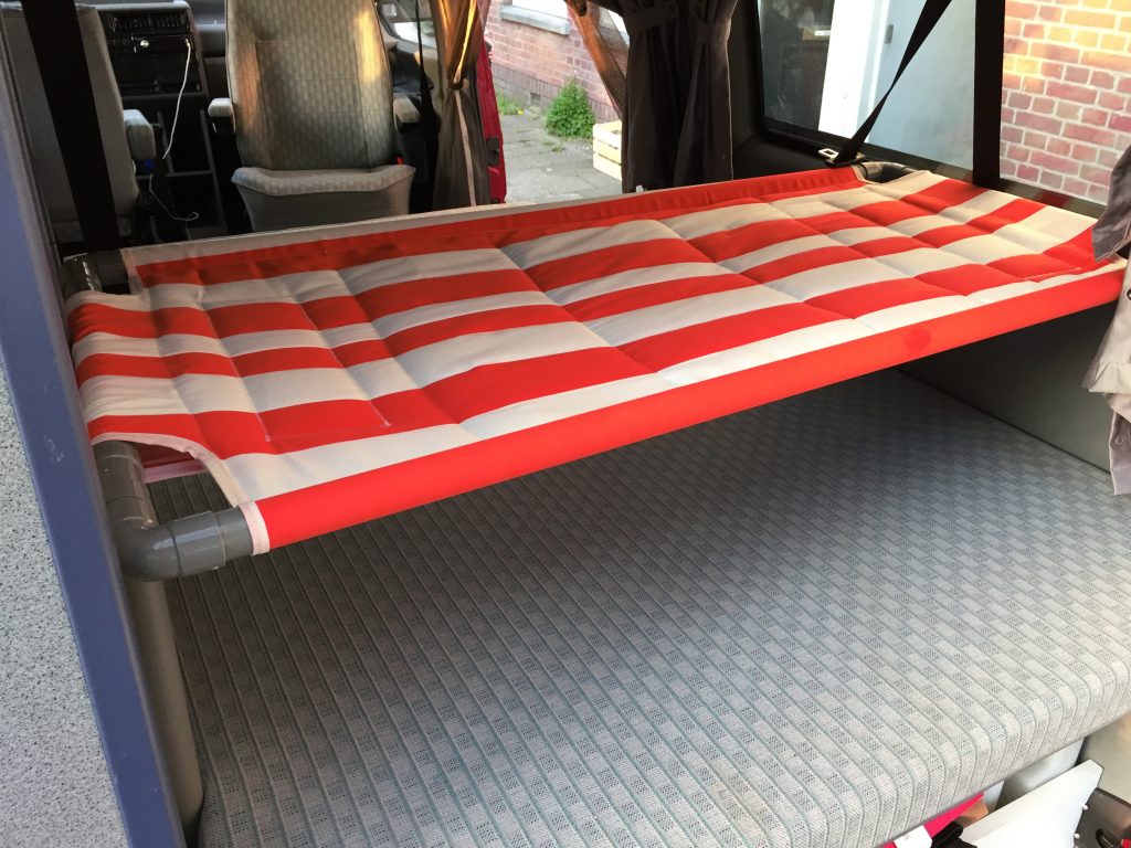

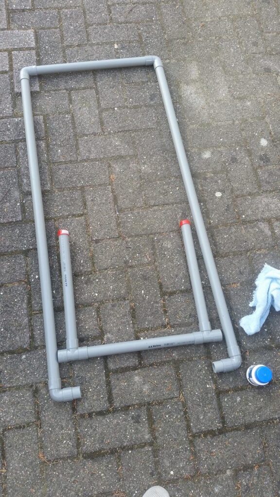

The frame is made out of PVC which is very leightweight.

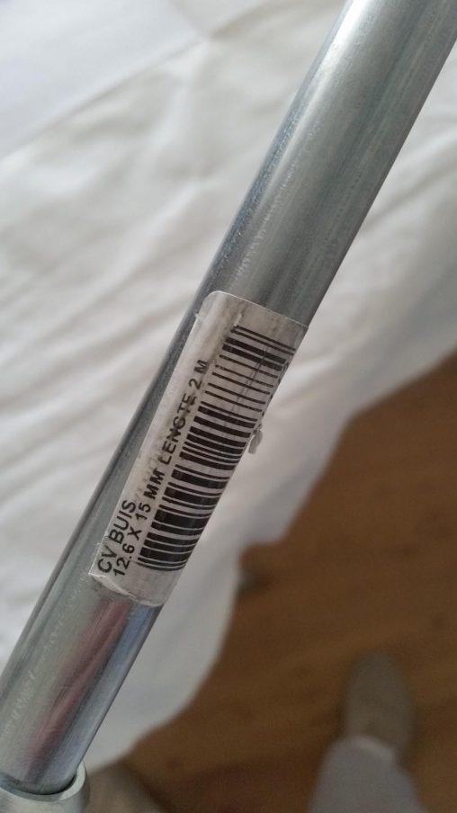

Just to be sure I added some aluminium pipes in the PVC pipe. You could skip this part as the construction will easily carry a small child, but with the added aluminium the bed can hold a much older/heavier child. And the bed still weighs next to nothing.

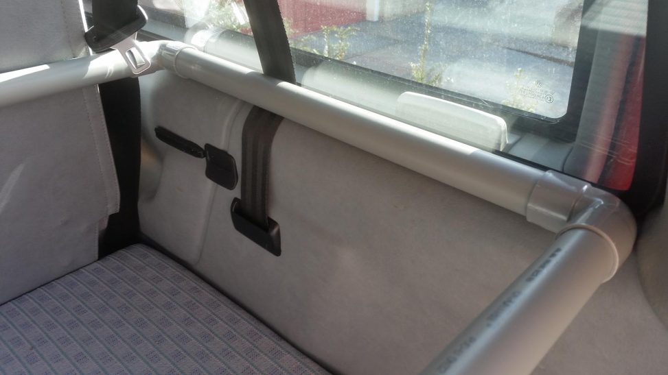

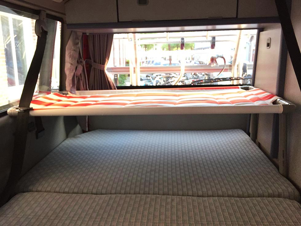

On the right hand side the bed rests on the window sill. So you don’t have to alter the interior of the bus. No lasting changes!
This is a close up for a better look. When our youngest is sleeping during the day, we can still keep using the bus normally.

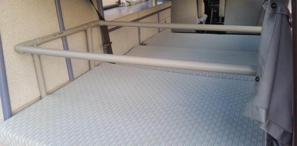

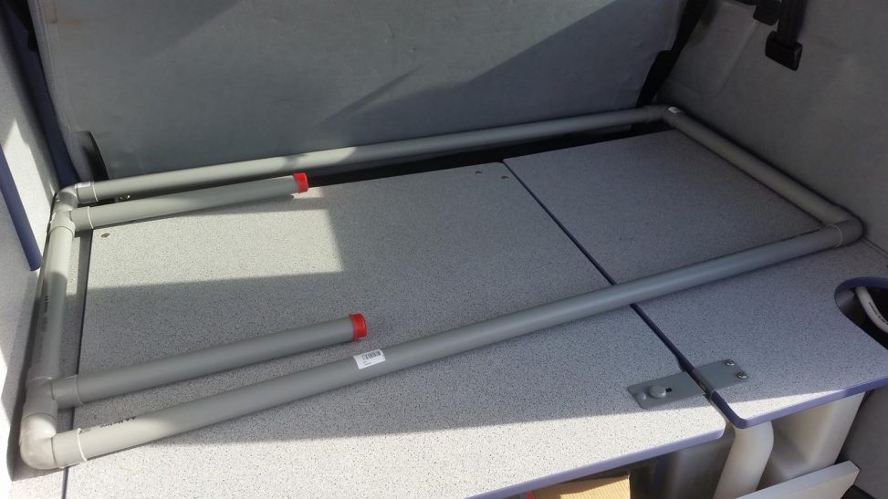

On the left side the frame touches the cupboard. We added two -foldable- legs on this side. Again, no alterations to the van.
Most of the frame is glued together except for the part with the legs, so the legs can be unfolded and folded (to store the bed).

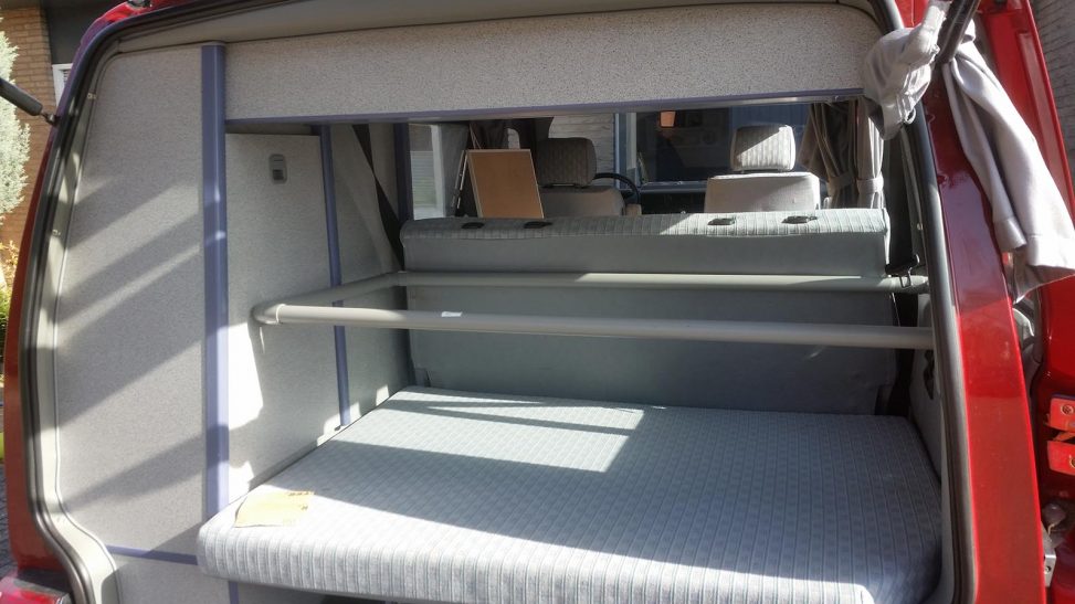

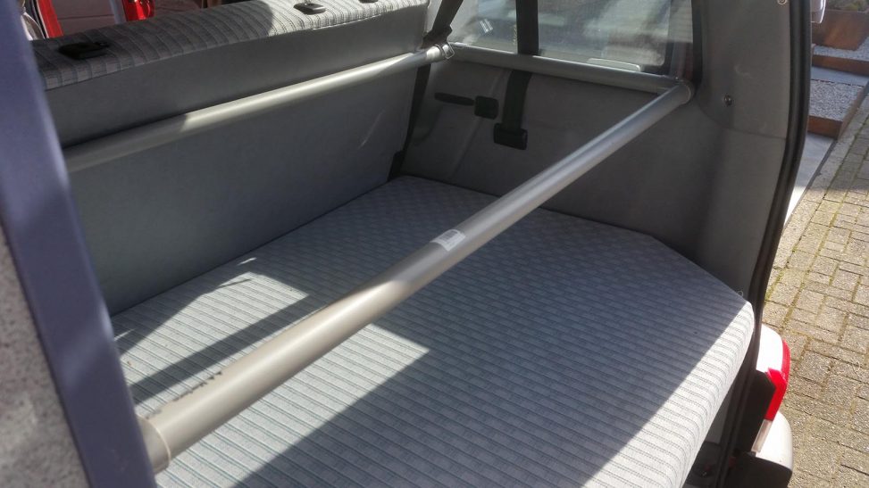

The entire bed fits perfectly beneath the matrass behind the bench seat.

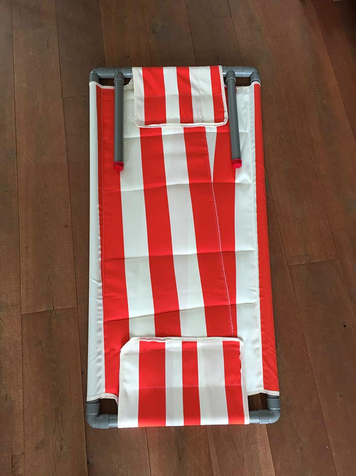

We added some canvas/fabric and used velcro so the fabric can be taken off and washed.
This is what the little bed looks like from the inside of the van. Our youngest can happily sleep over our feet this way.
