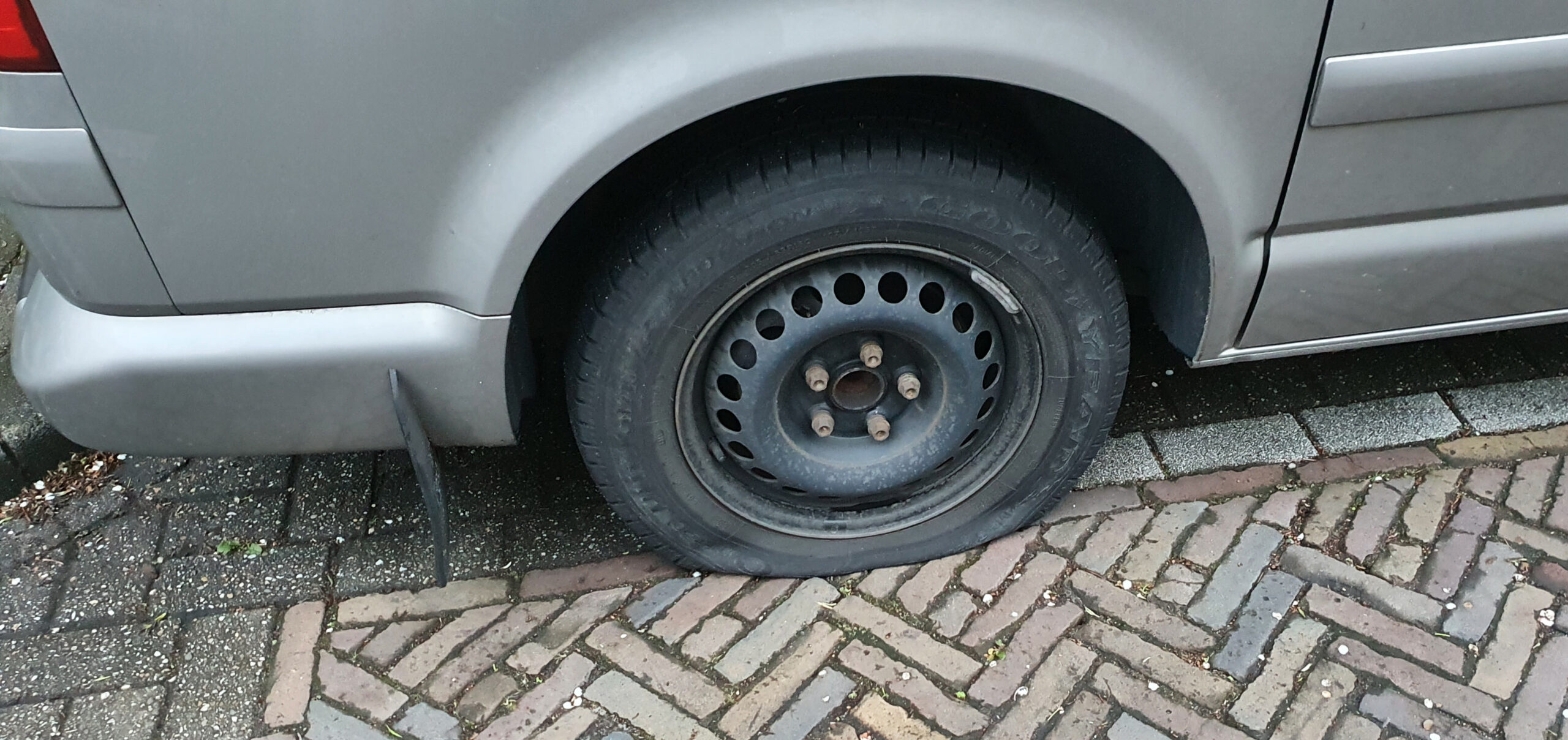

Got home from work today (in the Cali) and when I got out I heard a hissing sound. Turns out karma comes in the shape of a nail. Guess I was right; should've deleted my post. :headbang:D At least now I could laugh about it. Real hard. I'm sure the neighbours thought I'm some kind of mad man, laughing out loud at having a flat tire instead of being annoyed.
