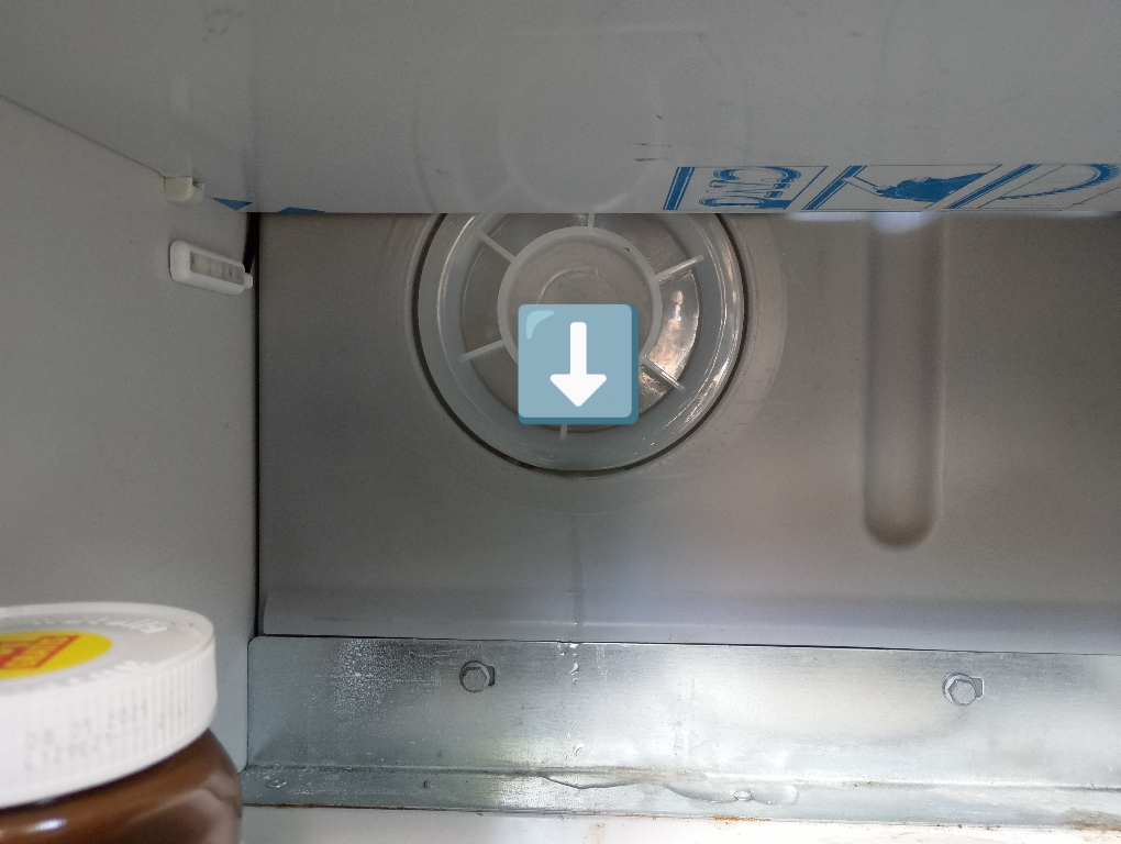

As an add on, I found that the level sensor in my tank (which only shows on the overhead display in the T6 as the tank having capacity or tank full) was not registering full even when overflowing rather embarrassingly on CCC site pitch
On returning home opened the round inspection hatch (after emptying tank) and found that the metal float was stuck to the sensor shaft with food debris/ oil emulsion.
Cleaned and recommissioned tank then flushed with soapy hot water until overflowing resolved matters including food debris.
I do this as part of a winter prep drain down of water and waste tanks and no repeat after 2 years
Just to show the level gauge for waste water in the control system not display.
I found that between the sensor triggering and showing full and the tank overflowing was one basin full after the sensor triggered and showed on the display as full.
