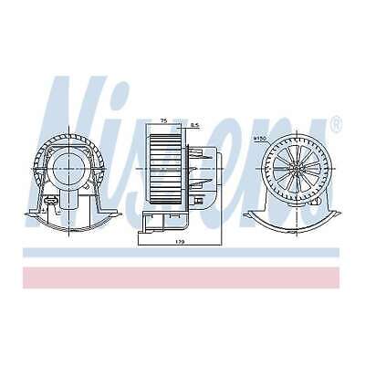

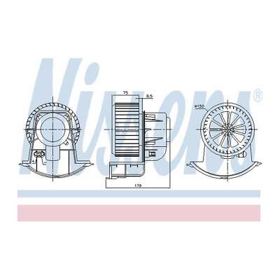

The heater motor wasn't spinning so phoned VW and they wanted over £400 to supply and fit so went onto eBay and found a replacement for £89.50 with a 2 year warranty. Fitted it and working within an hour... :)
VW Part No 7E6820021B NOTE RHD for model with electronically regulated air conditioner, second evaporator and second heater in rear
https://rover.ebay.com/rover/0/0/0?mpre=https://www.ebay.co.uk/ulk/itm/292979505413
The old motor had a stiff bearing in perhaps from water ingress. Changed the Pollen filter at the same time...DSC_0435.JPGDSC_0420.JPGDSC_0421.JPG
