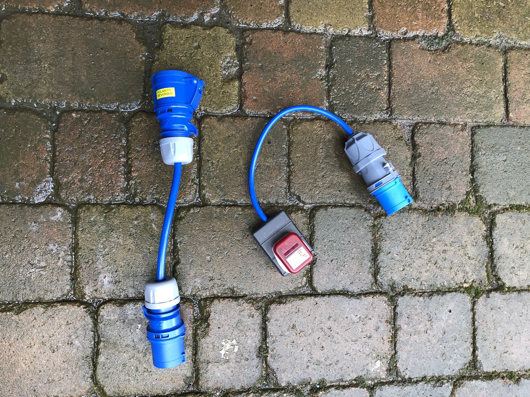

In my experience in Spain & Portugal I found that on several occasions the on site hook up either did not work/needed to be switched on/had reversed polarity.
To stop me wondering if it was the source or the Cali and at the same to check the polarity I use the plug to check as in below picture. If all is well I then plug in the hook up from the Cali. If power is ok but polarity is reversed then the other lead is stuck in the chain to reverse it.
My check in the Cali is to either check the icon in the bottom right of the control panel or plug the kettle in.
