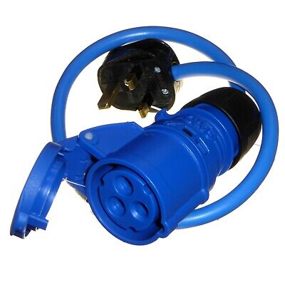

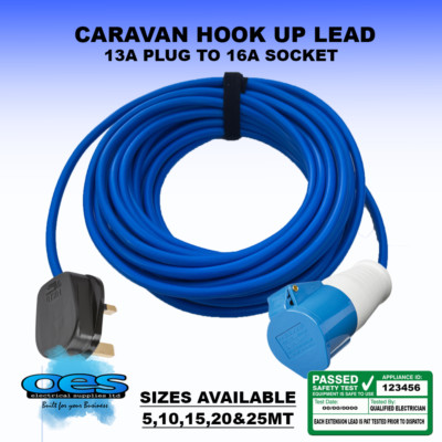

I know this might sound daft but what do I need to charge my van at home?
A lead long enough to go from a house/garage socket to the Cali with appropriate end connectors.
I've the Ehu that goes in the van but what abt the other end, do you have to have a 240 transformer?
If you already have a mains supply cable for on site use then an adapter will do such as this
Alternative is a dedicated mains cable for connecting to a UK 13amp socket. such as.
No Transformer needed as that is already in the Cali electrical system.
