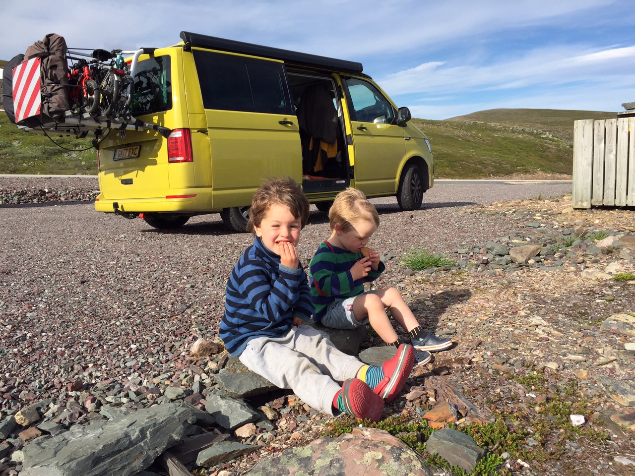

We had 2 Bromptons, a 14" wheel child's bike, a 12" wheel balance bike and a bagged double trailer on the back.
The Bromptons went in positions #1 and #2. The children's bikes went rear wheels overlapping in position #3. The bagged trailer rested in position #4, with two long straps around the bag and whole rack. Everything was further supported and locked with two custom made long cables locked together with a high security padlock.

Thanks Amarillo and great photo. That’s the kind of set up we are looking at with the fiamma storage bag on the back and bikes in position 1 and 2. I think we’ll get the bag and then work out how to secure it to the rack. As your photo shows, should be possible with a few straps.

Use the straps to secure the bag to the rack, but don't forget to lock it as well.
http://www.tecni-cable.co.uk/TECNI-Maxi-10mm-Security-Cable-with-Length-Options.
Two of the above, one wrapped around everything and through the bike wheels in a horizontal plane, the other around everything and through the bike frames in a vertical plane, will give you peace of mind when you pop into Lidl or stop for lunch. The cables can be ordered to the exact length you require for a nice tight fit.
Provided you use a quality padlock, thieves will need to be armed with bolt cutters to get your luggage and, if you have used and locked the arms, bolt cutters and hacksaw to get your bikes.

I think thieves favour angle grinders now, decent battery/disc will cut through anything, bit noisy but who will challenge them these days?
