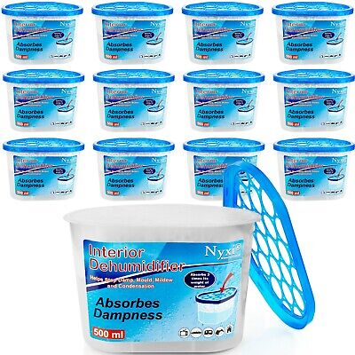

2 Plastic grids cut to size for back and base, from a £ Shop. But I also have a Disposable Humidifier that goes in the fridge when there is room. Never had to dry out the fridge except after the annual clean.
Tip everything out every couple of days, wipe dry with tea towel, start all over again.
@WG
Could you show the Disposible Humifier, I can’t find it on the web.
