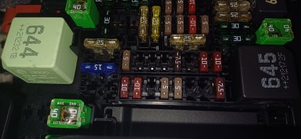

Has Any one Got a diagram for what each fuse is for on the California Ocean T6.1 please.

I want to install nextbase dash cam , need to either use 2 x Fuse taps or go into spare holders ?
Need a red VCC+ always on
Also ACC on yellow wire , only when ignition on .
Any idea best location within board to connect too ?
Surely someone on this forum has a detailed diagram ?

Just use a Multimeter to check which fuses are live only with ignition On.

This post should help you locate switched and always on terminals for your dash cam installation.
Thread 'How to hard wire a dash cam T6.1 Ocean'
https://vwcaliforniaclub.com/threads/how-to-hard-wire-a-dash-cam-t6-1-ocean.53206/

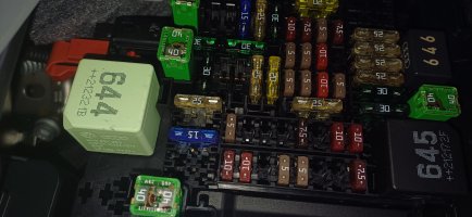

See your image with white area outlined for fuses switched by ignition. The poster I linked used the 7.5 amp fuse as switched supply
And in the lower row outlined in red the right hand 10amp fuse for the permanent supply.
Your photo edited
