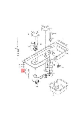

Part 6.
Check that the sensor on the affected burner is plugged in properly to the Control Knob for that burner.
It is correctly pluggen in. I'll see if I can change that when I come home. Thanks!
Hello,
I am back home, and would like to tackle this gas sensor problem. But first: how do I remove the gas sensor? Do I need to unscrew the two screws on top of the burner? With a very small star-screwdriver? (mine does not seem to fit)
