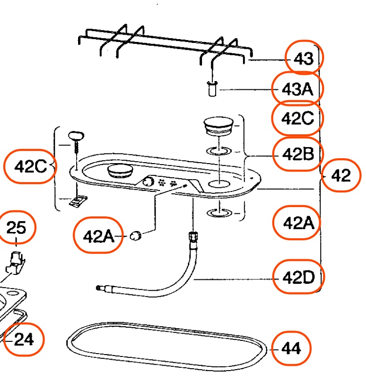

Looks like they were discontinued by VW in 2010.
I'm sure one of the T4 members will be along shortly with some advice. The VW part numbers are below.

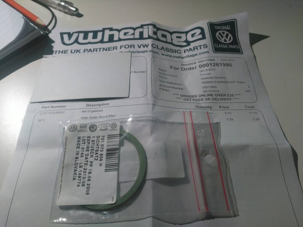

I have got some courtesy of the part number above and vw heritage. Took a while to arrive but they are spot on OEM parts and cost £3.70 for a pair. Part no is c701-070-606/h

can anyone tell me if the gasket set is the same for the removable and non-removable gas hobs? mine is removable but the parts diagram is not showing separate gaskets for that configuration.

Only two types of stove I’m aware of - gas or meths. The gas has gaskets above and below the stainless metal surface.
