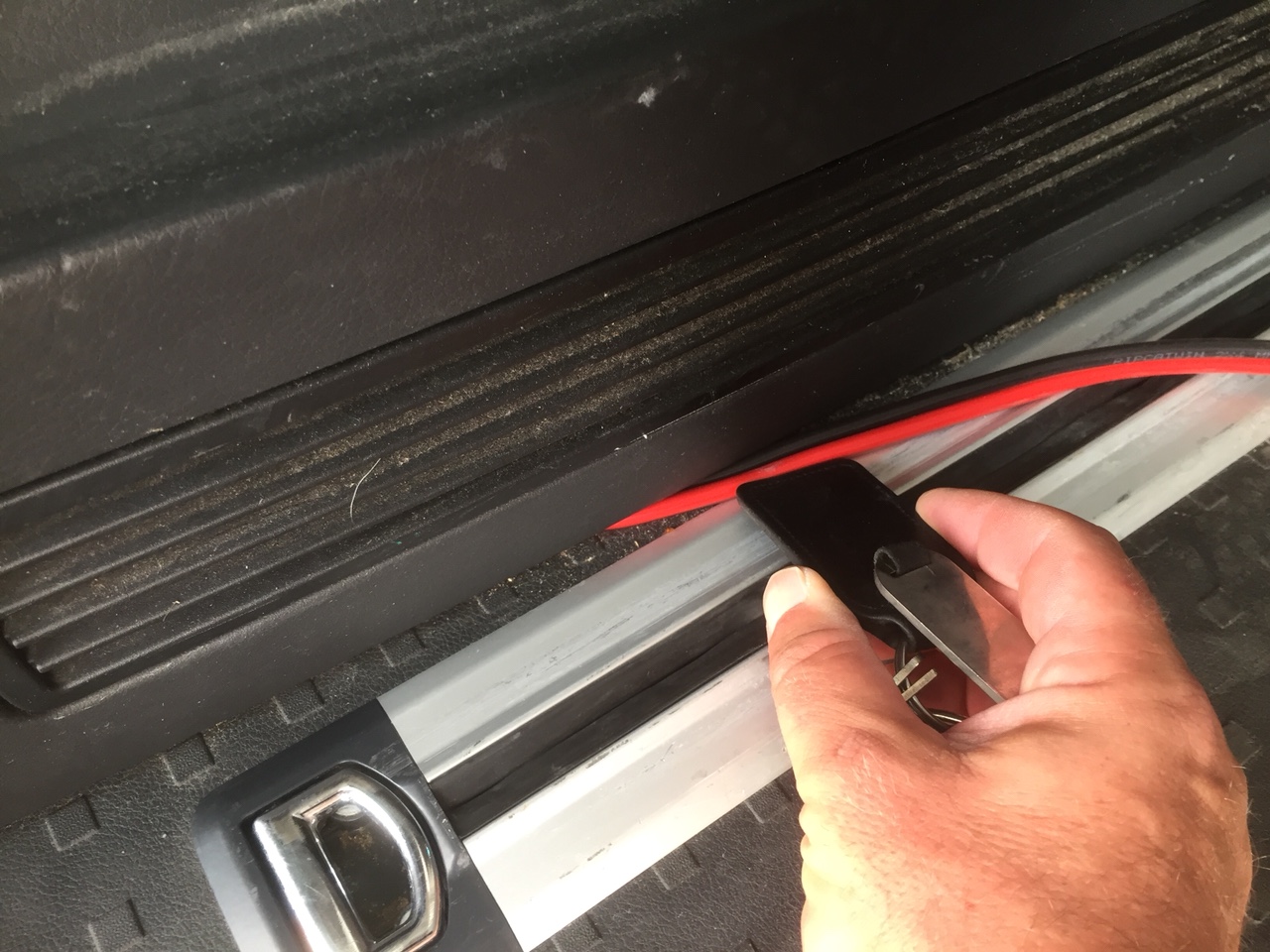

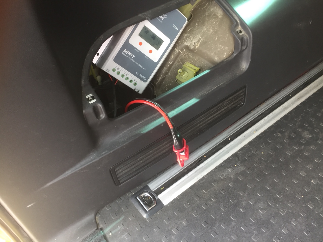

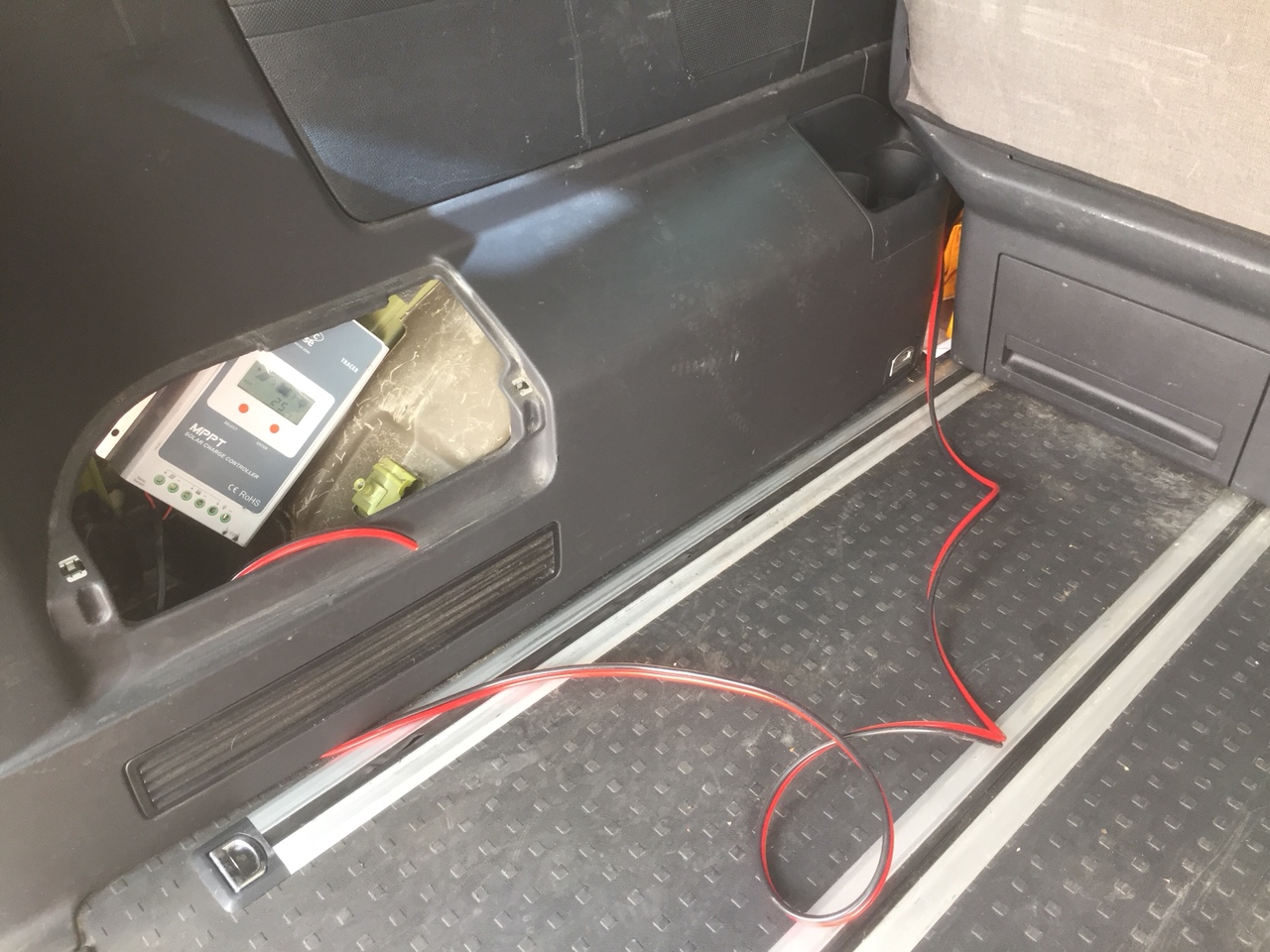

Ran the feed to the boot tool box today.
The hardest part was pushing the wire under the trim. I tried with my leather key fob, but ended up using a screwdriver for the toughest bits.
The meter reading was 14.24 volts on the bare wire ends. A little misleading perhaps as the solar panels were charging the battery at the time of the reading.
I made a ridiculous mistake when fitting the Anderson connector to the boot feed. After trimming the +ve and -ve wire ends I crimped the +ve and with the crimping piers touched the -ve wire and set off a great spark. I’d forgotten to disconnect the battery end of the feed after checking the voltage. The feed is protected by a massive 50 Amp fuse - it didn’t blow.
The next bit, running the feed into the awning case will be the interesting bit.
