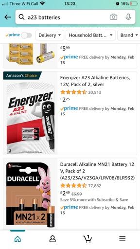

I found a few seconds spare yesterday and opened the remote.
Behold this.... mine has not only 1 battery but 2.
A23 batteries. Anyway, i warmed them up and they work again so i
might squeeze more out of them yet. :)
Digades make the remote controls but i can't seem to find their batteries
anywhere online.
anywhere online.
Obviously you got some German VW luxury version of the remote. ;-)

I've never bought anything through Geoffs firm, people look
at me strangely when i say i haven't got an Amazon account. :)
I did want to buy the same batteries that were supplied but couldn't
find them so settled for Energizer ones, only a 12yr guarantee but hey ho..:D
