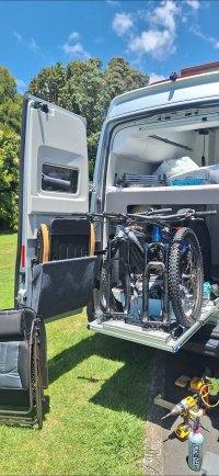

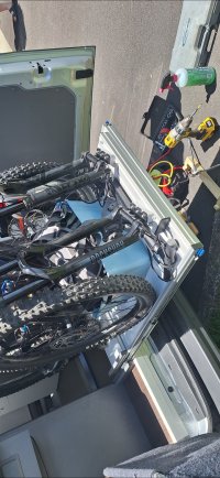

Inspired by the above, ripped out my squeaky wooden prototype and put together one out of 4020 and 4080 extrusion - with the cantilevered section above the hump in the rear floor.
Followed @G-A-R-Y and replaced the airline rails/trimmed corners of cupboards.
Happy with the results, but need to make more solid end caps (already broken a few)
