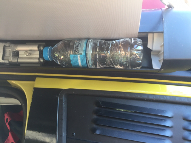

It's a big space, and takes a 1/2 litre bottle.
It'll fit in there, just depends whether you want the controller in the van re better protection from the elements, and you have more experience of the elements when travelling ;-)
I guess the test would be a roll of toilet paper in there during a thunderstorm and how wet it gets. A 12v controller must be able to take some level of splashing.

We have our 12v supply coming out of the van at the tailgate. It looks like those awning support arms can be moved forward, within limits, but the under casing void could be moved from the front of the awning casing to the rear of the awning casing.
The tricky bit would be getting the 12v supply into the awning casing while keeping everything rain resistant, but a small drill hole through the plastic end cap would be fine and the 12v supply sealed through the hole.
I think that the controller fitted in the void under the awning will be fine, and we can have a fit and forget RGB LED wind out awning lighting solution.
