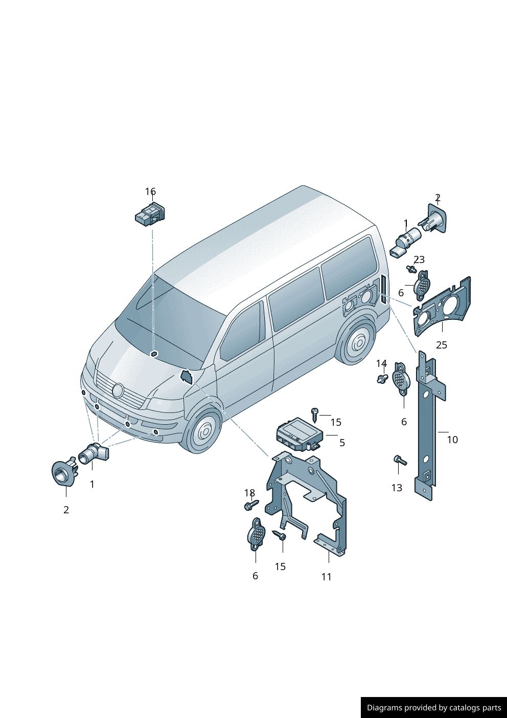

Click on link below. Part 5 is the Control Unit.
As far as I am aware the wiring loom runs up the Kitchen B pillar, behind the kitchen lights trim , through the wardrobes to the rear D pillar then down and through floor to back of rear bumper.
Corroded wires on the sensors don't involve taking down any trim. Just unplug the sensor connectors and check it out.
The unit also just seems to be behind the dashboard, not the water tank.
