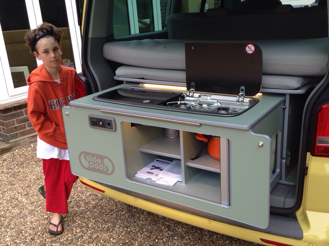

Worth looking at Slidepods. Ours is really special.
I managed to see an maxxcamp compact for the first time when away in Switzerland over the summer. Great kit expensive but very well made and thought out. If the slidepod inside pod comes out and doesn't suit that's what I will save up for.
The Slidepod looks very cool but I just don't get what you do in winter when it's minus five outside, the problem with the UK is our winters are longer than our summer so I feel the Slidepod is only for seasonal use. I personally would not want to be cooking dinner in November with the tailgate open letting all the hot air out.
Maybe I am missing something?
You can easily remove the slidepod and use it in your drive away awning if you have one. I've seen some with rear awnings setup.
I know Jonny has a plan for an internal smaller pod but I also know he has been so busy this year he doesn't know when it will be available.
What happens when you fancy an impromptu cup of tea in a car park? I would feel very strange opening the tailgate and exposing my pod to everyone, also the space under the multiplex is soooo useful for storage, I would hate to lose that area.
