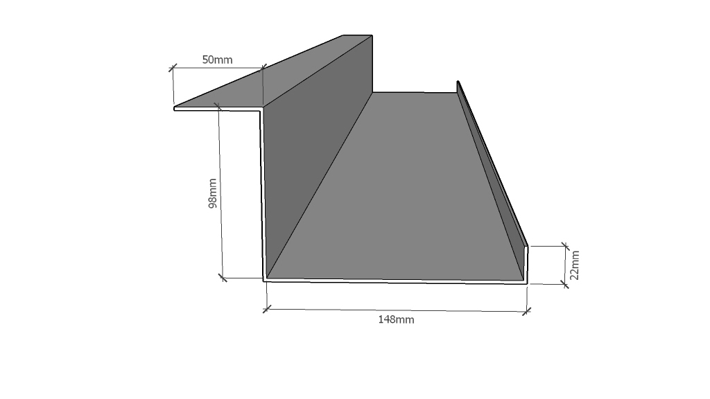

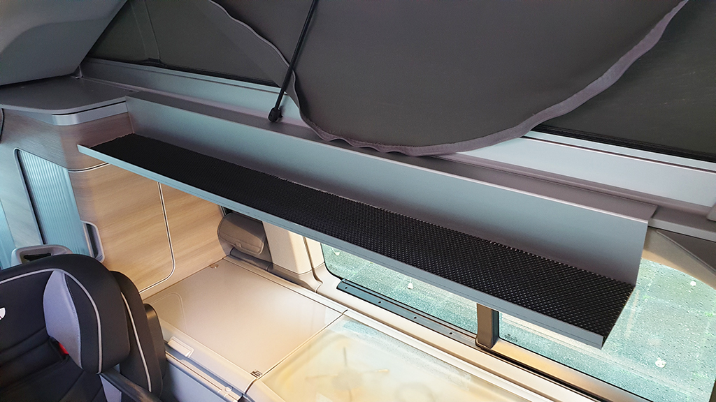

Indeed a nice DIY-job! Impressive that you did it without professional tools. Another possibility would have been to figure out what dimensions you wanted and let a aluminiumshop make it to your desired size. It's what I did. Made a model (which you can freely download here) and just asked the aluminium shop to make it. The whole thing cost me 55 pounds. Added some anti slip mat and you can perfectly leave stuff up there while driving, no problem. You can find the full DIY-explanation in English here.

you are certainly correct. May I offer a suggestion/improvement ? from your design, you must have glued the 5cm wide part to the frame of the cali. if you had instead added another 1,5 to 2cm to the 5cm part and bent it upwards to go inside the frame (the aluminium part where the gas strut of the bed is attached to) , allowing for an open 2x2cm hole to go around the gas strut attachment, you wouldn't need to glue anything, not it could slide forward .
Also 2mm is much stronger than mine 0,8mm, but heavier, more expensive and may leave a mark on the under side of the bed. Since you are not putting massive weights on such a small rack, but more likely small items, I've found 0,8mm to be sufficient. And i think there's no way I could have bent buy hand such a large (1m wide) piece of 2mm alu.

Well, now I've lernt what Tesa Powerbond Ultrastrong is and that it can be removed clean albeit with a bit of work. I still do prefer a mechanical attachment without glue if possible, so I can quickly remove, modify, etc. Without the edge lip I could fit the washing bowl which proved to be a game changer in term of space gained on the kitchen unit.20221031_154802.jpg
...Without the edge lip I could fit the washing bowl which proved to be a game changer in term of space gained on the kitchen unit.
We've had the "bought" add-on shelf (can't remember who makes it) for years and it's extremely useful just for popping things on and off both during the day and in the evening. Even with the roof down you can still use it for phones etc. Made or bought, a genuinely useful Cali accessory.
