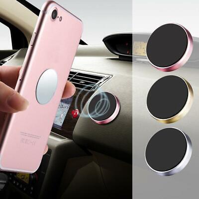

I had the same issue out of warranty. Simple fix. I used something similar to this
