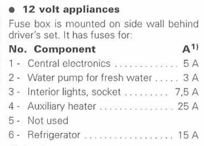

Anyone have a diagram as to what the 5 blade fuses behind the drivers seat each do?

Ok, so plot thickens...
Managed to get some 3amp fuses. Plugged one in and hey presto, the voltage display comes back, the fridge fires up and all seemingly great...
However... (you knew that was coming!) - If I try the tap then fuse blows again.
So, new problem (well i guess the original problem, but now I know it for sure), why's the tap blowing the fuse? Water ingress? Anyone had this before, what to check/where?
