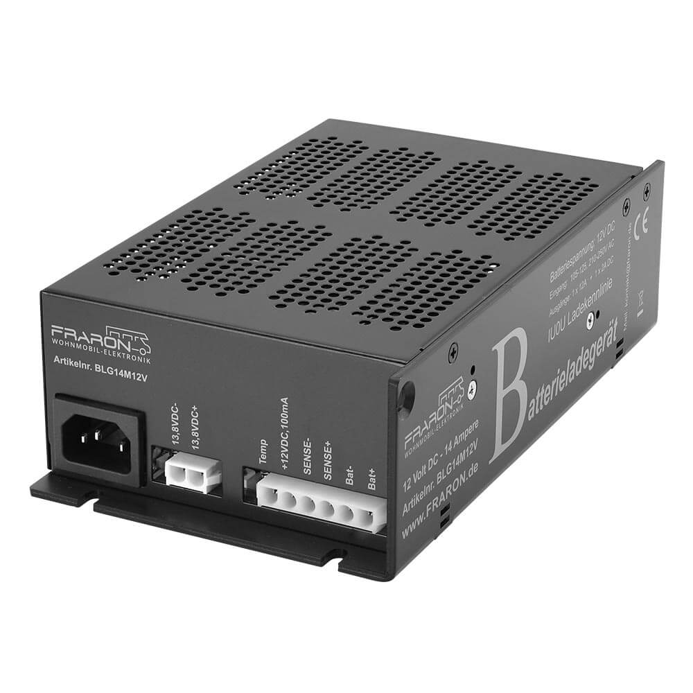

I just wanted the prings led and a new charger, 150 cdn dollars rather then the 600 euro for a Fraron that wont work here or ship to Canada.
So what you are saying is the green cable going into original charging unit needs 5V so indicate the prong on overhead display? I remember seeing somewhere 12v
Fraron is not any good for North America and I managed mine for 150 cdn, using a modern charger
