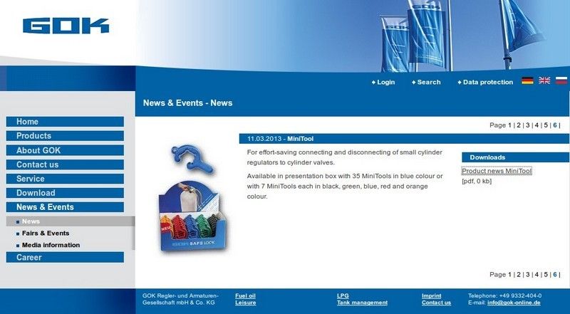

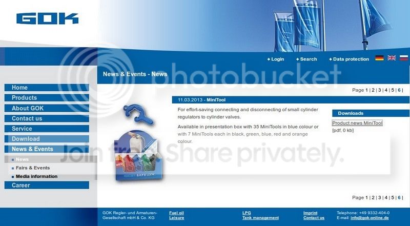

Of course we all know you should only tighten the gas fitting by hand, don't we?
But did you know the manufacturer of the gas tap (GOK) sells a nice little plastic tool to make tigtening just that bit easier (& tighter...)?
http://www.gok-online.de/en/news_press/aktuelle-news.php?startNews=20
https://www.svb24.com/en/gok-minitool.html#more_info
http://www.wohnkabinen-shop.de/en/g...e-system/gok-mini-tool-fuer-gasflaschenregler
So maybe we can admit to using (CAREFULLY) any other little tools we have handy?
