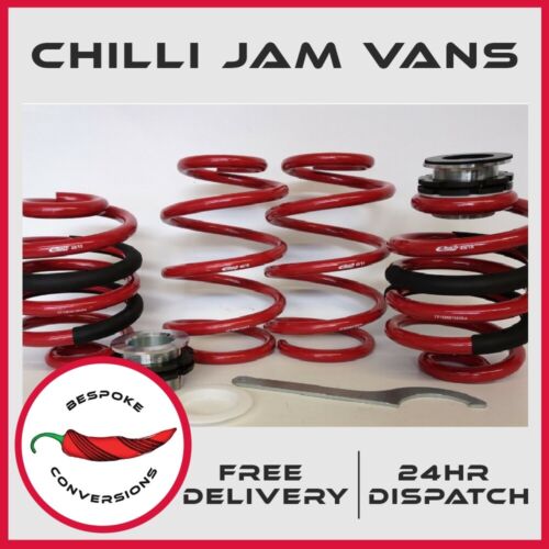

Good option now is Eibach adjustable height set as you have a range of lowered position to suit you.
example
