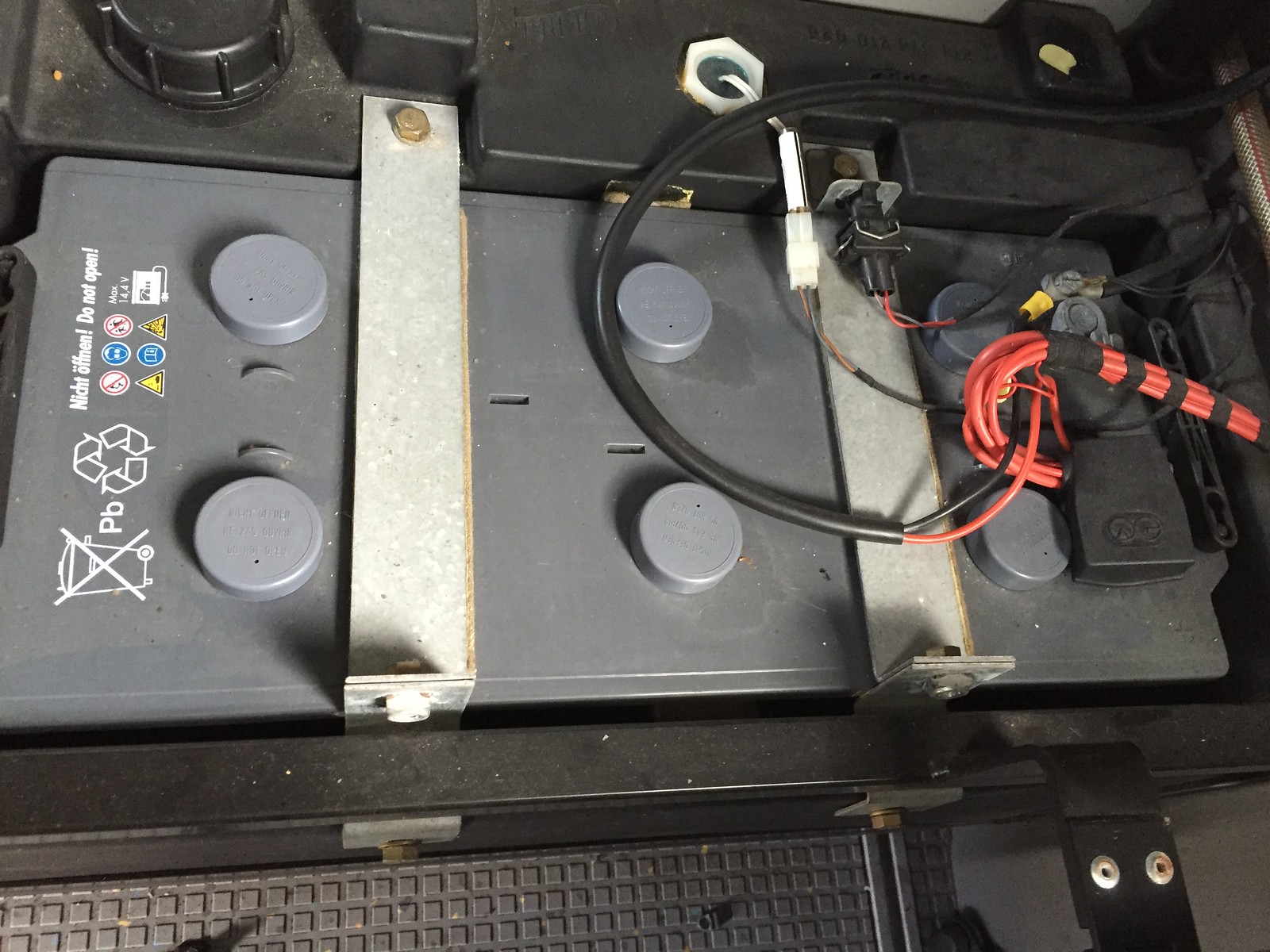

I've just wired up my solar charger with some fresh panels after the last owner nabbed them. The settings have reverted back to factory setting on the charge controller (Solara) which was for lead acid batteries. I've changed it back to gel thinking thats what the battery was but I just wanted to check thats correct. I've looked though a load of past threads and I getting the impression its gel but I cant seem to find a definitive answer.

Sonnenchein I believe. Exide nowadays.
There was an alternative original fit but I can't recall what it is. It's in the control panel set up manual.

Here we are. Deta was the other brand.
Here Sonnenchein has been translated as Subshine.
Cheers chaps. I thought it was. When the warning says no more than 14.4v was another clue for me
