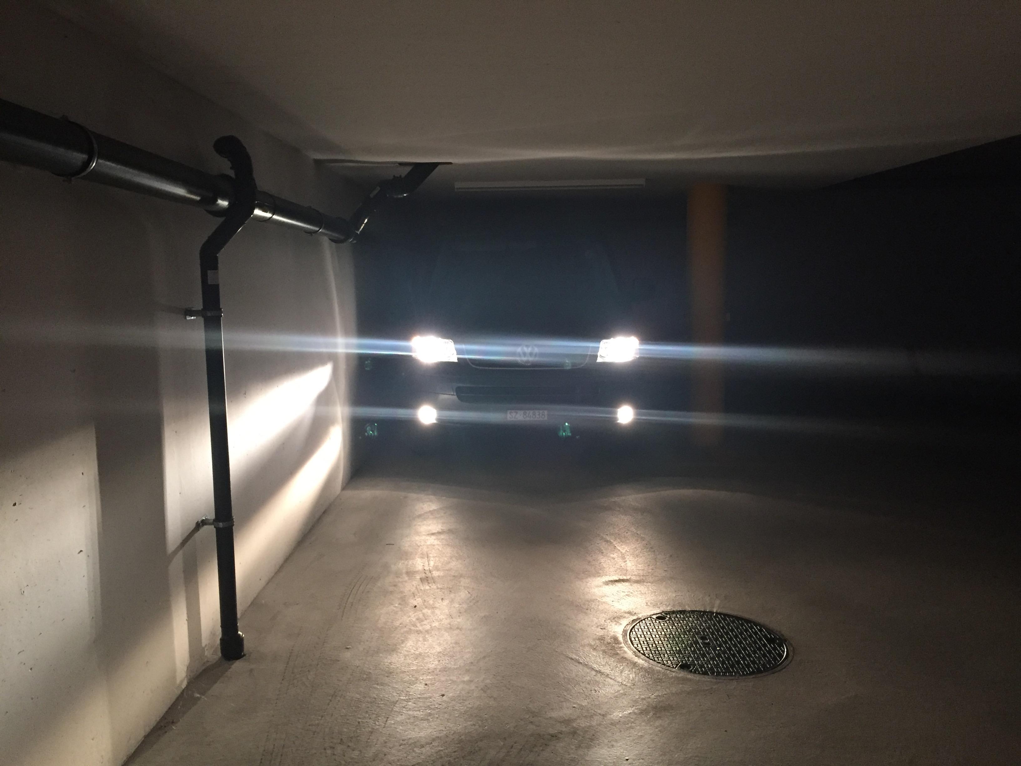

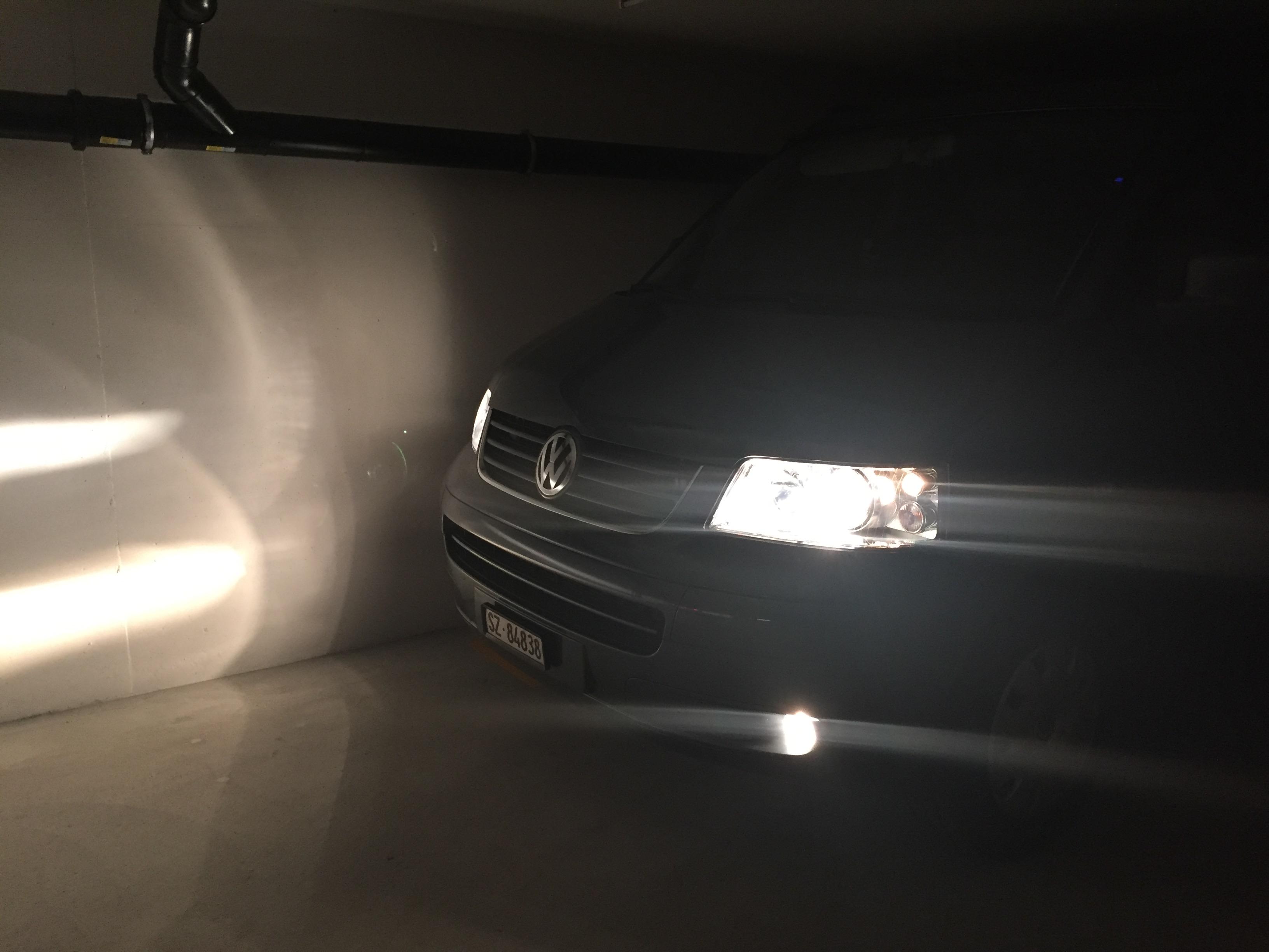

They make a big difference for the better, and they are easy to fit: you just change them, like you replace a bulb when it is broken.
