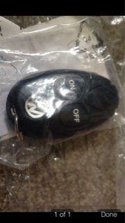

Thanks for that. It's the one which is more angular, rather than the rounded (coolant heater?) remote, like this;
The manual is extraordinarily confusing when it refers to "supplementary heating" it doesn't differentiate between the parking heater & the aux (coolant) heater

Whoa thats expensive.
The T90 Telestart unit comes with the whole remote start kit for the heater and antenna plus the keyfob and is about 160 Euro.
£150 for just the remote? That seems like the price is the same as the whole remote start kit for just the fob.
I think Alex would probably the best on this though.
Not sure the Cali is the same but the ability to control the automatic turning on and off using a timer/calendar on the console could be coded on the Phaeton (uses the same heater unit but different console) without having to buy the remote which was a good halfway house option without the expense, if your memory is up to setting it up the night before. the modification is 2 minutes and it was free :p.
If the codes are the same between the Cali and Phaeton and someone has a VDS we could try it at a meet sometime but I fear they will be different.
