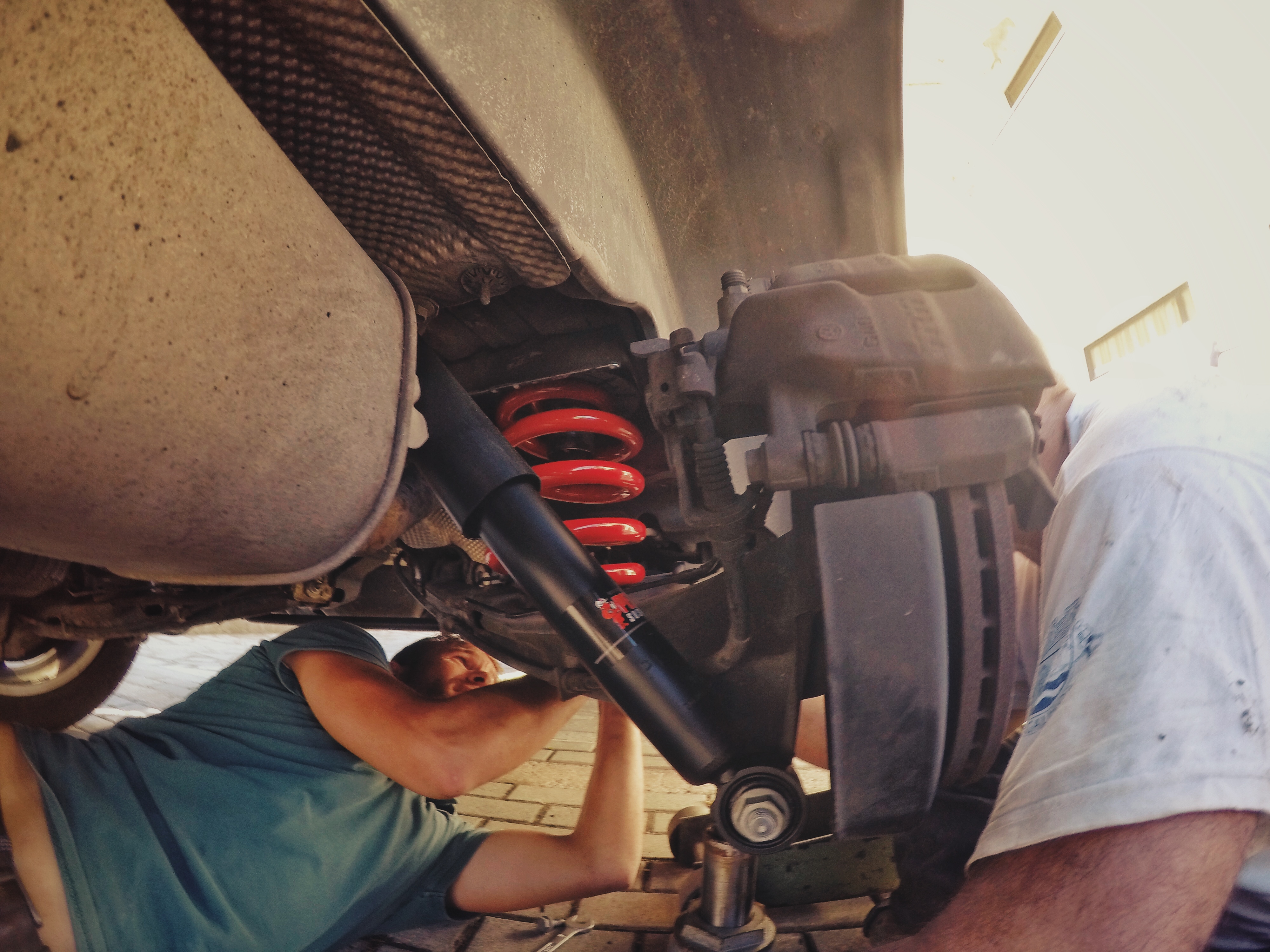

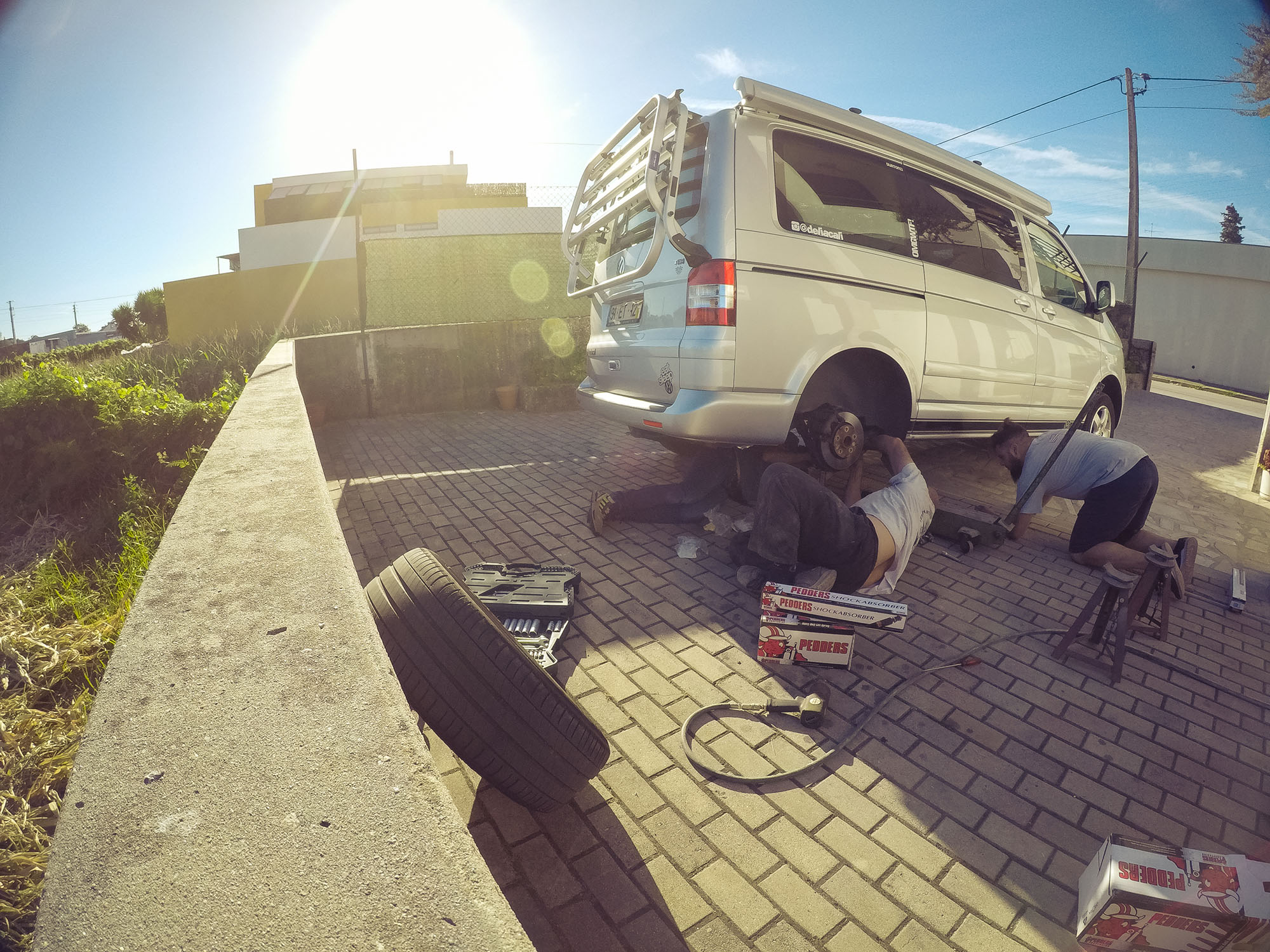

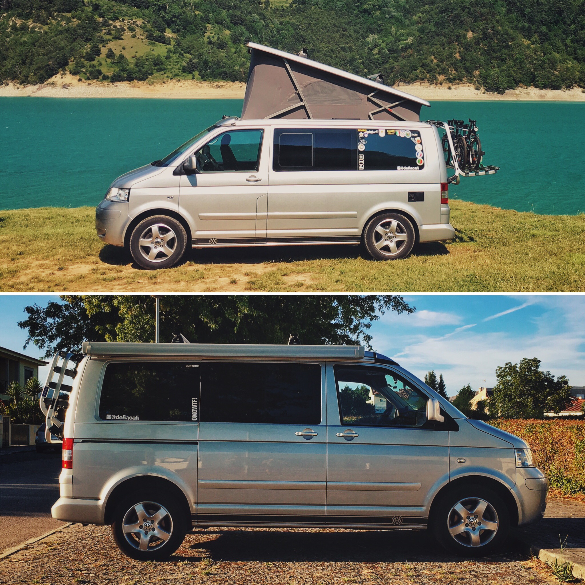

Just fitted the Pedders rear kit yesterday!
After being annoyed by the saggy rear for so long, I decided to fix it and get the Pedders kit.
Quick to arrive (mind you I'm in Portugal!), it was less than an hours work done at home, with help from a friend!
The rear was lifted by 5cm!
Haven't had a chance to do a proper drive on a windy road, looking forward to it!
