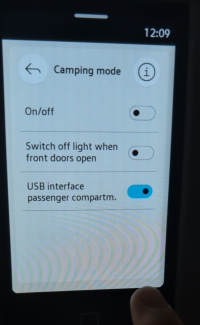

Hi, a bit off topic but still on rear sockets. Non of the 3 usb c rear sockets on my van are giving power when parked, surely they should be running off the leisure battery, is there a setting I’m missing???

Had another look this morning, there is no setting on my screen for rear power, just max and normal. I also checked and the usb sockets work with the engine running, so it seems just no leisure battery power
Try turning camping mode on from the California app on your phone or the screen at the rear.
I just checked and it turns on the four USB-C sockets in the rear.
Mine appears to be different, apologies if I’m being dumb, but I can’t find any other options, just camping mode on is blue, white is of. I know this is working because when it’s on it shows engine battery voltage
Ok just got that menu up by going into the app settings and telling it to synchronise with the van. However, when the screen shuts down it goes back to how it was, menu gone. Gave me enough time to turn the usb settings on, so cheers Ian, don’t know why that menu is not on permanently, but anyway sussed it :thanks
To get to this menu, I believe you need to press the home button once to wake to screen up - this will take you to a sort of quick menu. If you then press the home button again you should get the full menu. If you select Camping Mode in the full menu, you should see the options Ian has highlighted above.
Hope that helps!
Hope that helps!
Thanks for that, works perfectly, and I’ve just discovered the California van life app for the other functions I was looking for, Geez that manual is crap, and tbh I think my handover could have been a bit more in depth, so thanks to the boffins, I’m sure they’ll be some more noob questions coming :)
