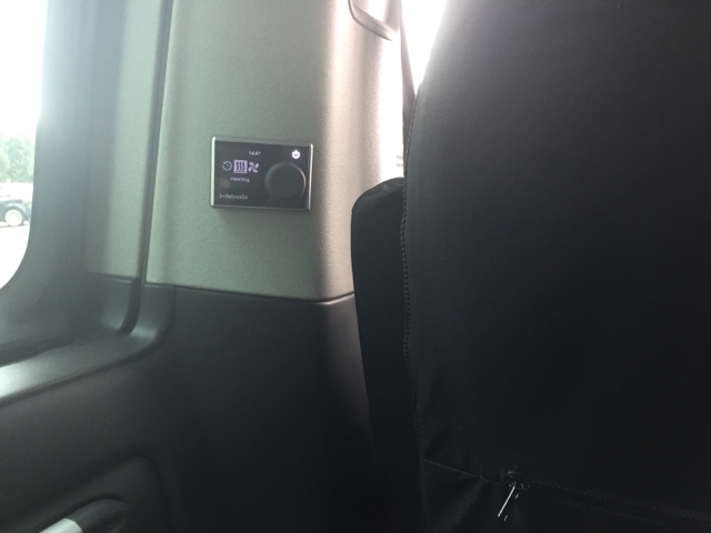

Yes as per my thread ( https://vwcaliforniaclub.com/threads/california-beach-gen6-ocean-red-beach-bulli-project.22394/ )I had the Webasto Heater installed two weeks ago at Exploria with 7-Day timer and Factory vents and am very pleased with it! (See my Beach-Bulli thread for pics)
Gazellio, that looks a decent fit.
Nice:cool:

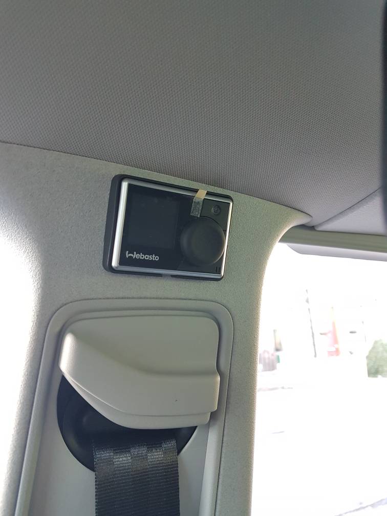

Exploria did a brilliant job installing a webasto heater for me yesterday. Very similar to the job done for gazellio with factory vent intakes/outlets. I went for the 7 day timer controller on the B pillar just above the seat belt. Can't recommend exploria enough. Very friendly and helpful bunch.
It was also terrific to meet @bilberry. :)

Well done glad they sorted you to the same standard as mine I was very pleased with them. Good location for the timer if you want to avoid it getting knocked. I wanted mine on C pillar so I could turn on the heating from my bed. :thumb
Now we have three locations:
timer7day-jpg.29867
Good plan. I was also trying to avoid the situation of my young kids fiddling with the controller in the back while I was driving. Visions of being on motorway with the cab at 35 degrees and not being able to easily stop to turn it off!
