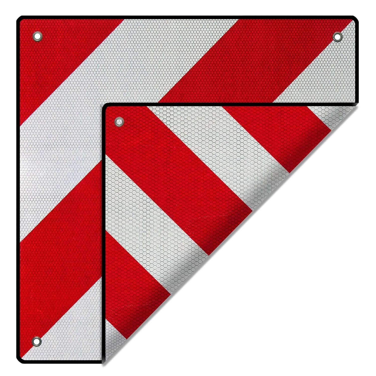

Please be aware that an increasing number of EU countries require approved large reflectors on protruding bike racks even in the folded position if they project beyond the vehicle footprint, even by cms. In Italy their is a defined, approved reflector which must be in Aluminium as made by Fiamma.

Use the one that Welshgas mentioned as above, other methods, tape etc not acceptable in France, i live there for part of year, unless of course you want to pay an on the spot fine if stopped.

Any reflective tape facing rear needs to be red.

Do be aware that the design of the red and white striped board differs between Italy and Spain.
The plastic Fiamma one is for Italy and has 5 red diagonal stripes. The Spanish one should be metal with only 3 red diagonal stripes. I bought a slightly more expensive reversible metal one off ebay.
Having said that, I saw mostly plastic Italian boards in Spain on our last trip.

You are correct regarding the number of strips BUT Italy insists on an Aluminium sign. Plastic is not legal, but you might get away with it.

Yes. And beware, they are not the sam for Span and Italy. Så you need two different types. You can get two-in-one though.

Yes. From what I have read.
This is the forum at its best. Providing really useful info to members that don't know from people that do know. We are off to Spain next year on our first big adventure (if the camper arrives, still status 10) and I was until now unaware Even of the existence of this warning sign, let alone having to own one. Thanks all for sharing your knowledge. Should have put it on the Christmas list, especially as it's in Santa's colours too. Oh hang on, my camper related Christmas list is already longer than the VW options list. I might just have to buy this thing myself. Though £26 seems mighty high for a small square piece of tin (alli).
Apparently if you have Spanish number plates you need the Spanish version. If you have any other European number plates then the Spanish or Italian sign is permissible.
