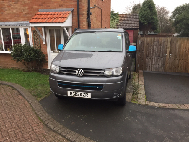

My wing mirrors are finally back from the spray shop, no longer yellow but now a nice kingsfisher blue to match in with my pod and general theme. So I want to remove the original wing mirror caps without damaging them.

Finally got around to doing it and so paid the garage to fit them 30 mins and got the old ones back without being broken.
I Just like blue has blue streamer in grill thought I’d try it and see if I liked it. Can always change them back to the grey ones
